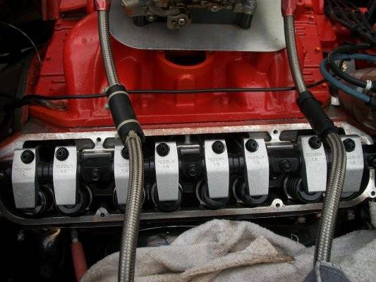

I have been using these Hughes since 2011 on my car and they have worked awesome. But I run a solid flat tappet cam and standard rockers with my basic EZ heads. They have been flawless for me. I have not used their or anyone's offset rockers myself as I can only say these standard Hughes rockers have worked great for my application. Ron
