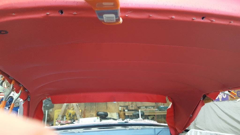

I did mine in my '67 Coronet with a 10-point cage and it wasn't horrible. Just go slow and pay attention to the dot pattern in the headliner and use it to make sure you are keeping things even side to side. As long as you do that you shouldn't wind up with any large wrinkles and should be able to use a heat gun on low to work out any imperfections.
