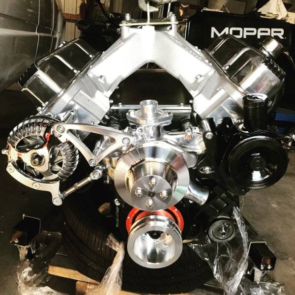

Did some research and seen a few different “methods” so I figured i should ask my friends here. Is there a proper way to break in a roller motor? I don’t think it needs the whole 20 min at 2500 deal. I’ve read on google searches that you can start it let it warm up to operating temp rev it a couple times to 3000 and shut it down? Is there any real method to break in a roller motor?
535”
T&D roller rockers
BAM roller lifters
Comp roller cam
