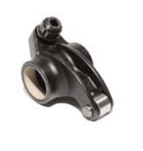

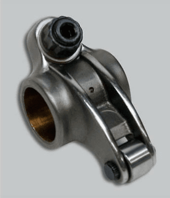

I bought Comp Magnum rockers for mine, I checked the contact pattern.. looked perfect. I've got 18,000 miles on them so far without any issues.
I like Harland Sharps but went with these because I liked the idea of them being bushed vs bearings seeing how they're well lubricated through the shaft.. one less thing to fail.
I like Harland Sharps but went with these because I liked the idea of them being bushed vs bearings seeing how they're well lubricated through the shaft.. one less thing to fail.View attachment 1148406
Have these myself but they're not bushed. Just rocker body on shaft deal. Maybe the newer ones are bushed.
Are you sure yours are Comps? There's a knock off sold by Proform & PRW that looks allot like the Comps but the early version wasn't bushed & were prone to galling on the shafts... The newer version seems to be a decent part, lotta guys run them... I still prefer my old Isky Ductile Iron rockers but they've become collectors items so...

Early Comps weren't bushed. Neither are the Mancini rockers. It's really not required till roller spring pressures but definitely nice to have. It's the reason I'm going to run a solid flat tappet cam as I don't feel like dropping the money on better rockers just yet.
