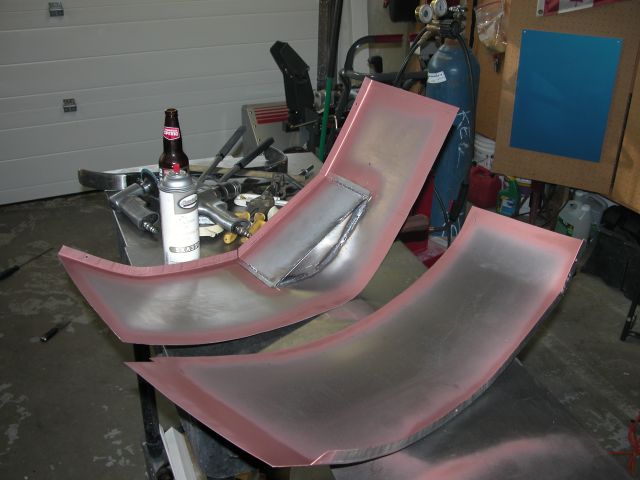

It's a zinc rich primer (cold galvanizing) that is applied only in the pinch weld seams over bare steel that aids in corrosion protection. It does incresase the difficulty level of welding a little, and generally requires a slight increase in the heat (voltage) setting to compensate for the zinc. Of note, that is the only real purpose for Weld thru primers, they have a low adhesive factor, and should never be top coated over as well.
BTW, we should always use this material no matter how much of a pain it can be...their is a variation on the material that uses copper instead of zinc which is easier to weld through, but it is not a sacrificial metal and doesn't provide the same anti-corrosion characteristics that the weld thru will. If you have a lot of welding to do, invest in a P-100 fume respirator while working with these materials...your throat and lungs will thank you and extend your beer drinking days considerably...

Here's a pic showing where I will use the copper based material, these seams will be completely sealed up so the copper based stuff works here...I will use the zinc based material in the seams on my floor pans to the frame rails that will not be sealed and more exposed to the weather, heaven forbid precious see's a wet day...lol
