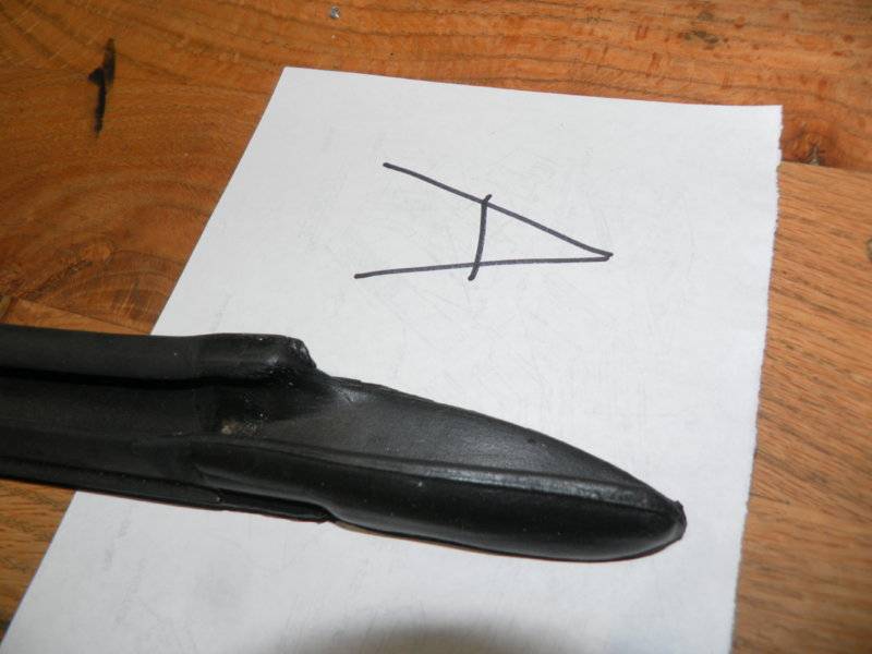

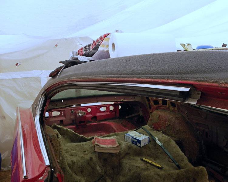

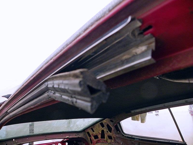

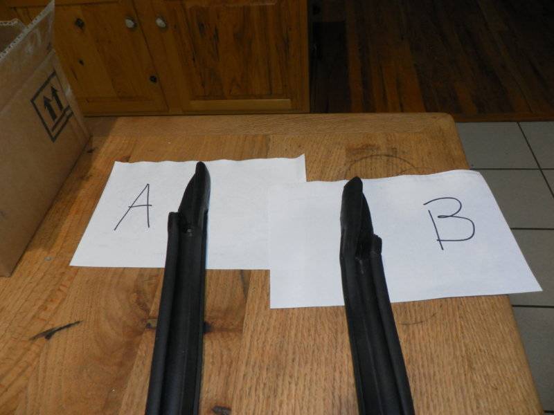

These pic's should help... hopefully... I think this is the one your asking about.
yes, thank you
