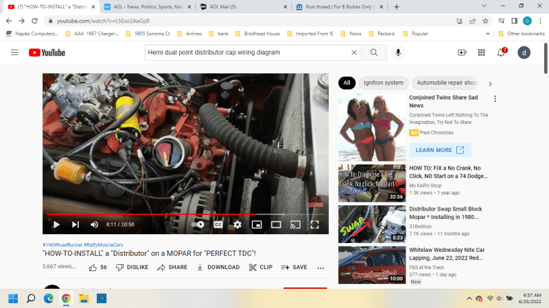

I was watching a YOUTUBE video on installing a distributor in a big block. I have a 426 Hemi, first time for me, and I had posted months ago a question on setting my dual point distributor into the engine. I understood that I was to make sure that the oil gear drive was set in with the "slot" front-to-back at TDC. Drop in distributor with rotor pointing to #1 spark plug.
I have done that and am having trouble with the car not starting. So I have set and re-set everything we all do in troubleshooting.
But I just watched a YOUTUBE MOPAR video" How to Install a Distributor" and he has the fat end of the rotor pointing toward the #1 spark plug, he calls it the mushroom side of the rotor. Is that correct? A few comments on the video told him he was wrong and I have never seen that done before on other engines BUT I have never had a 67 Hemi with the original dual point distributor. Can someone set me straight on which end of the rotor should point toward the #1 spark plug?
Read the comment below posted by the YOUTUBE GUY to another party who questioned his video:
NOPE Sorry Your Wrong Man....Big "Blunt Mushroom end points at number #1" on a Big Block! The Car Fired right up in an instant after this.....if you point the distributor as you are saying you would be 180* out and blow flames through your carb and car would never start. NOW on a GM you want pointed end to #1 but MOPAR is opposite!
