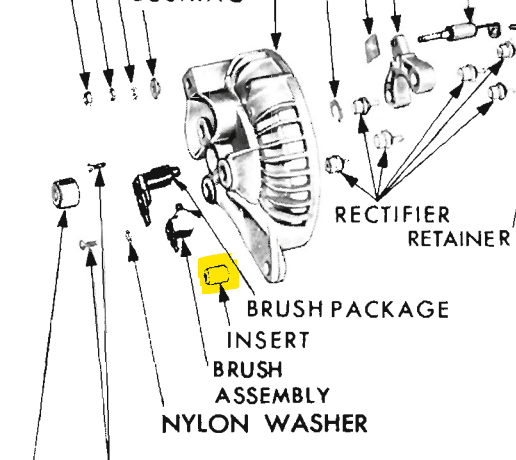

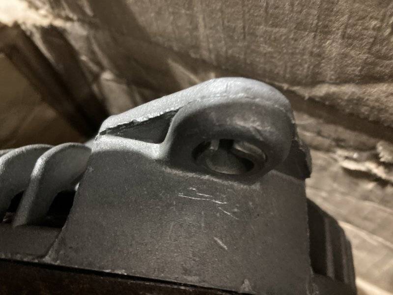

Does anyone know what the part number is for this part? I looked in the service manual and it is called an insert in the 70 diagram but in the parts book, it is not listed. Just the insert/bushing/spacer that fits into the mounting hole that is closest to the engine. I know I could use washers, etc, just wondering if there is a specific size or part for these. I've gotten a few kits over the years for brackets and spacers, but this is never included. Thanks!

It is a critical sliding spacer. Washers can cause case distortion and alternator failure. Any alternator/starter shop should have them.

Probably best to start a wanted thread. I don't believe I have ever seen the for sale separately.
Looking in some of my other parts manuals the same number 2095052 was used up into the 1980's

Square back takes the same bushing. It is not a normal bushing. It is like split and spring loaded. It also is an odd size as I remember. I have see guys use a bushing that does not fit right and it vibrates the crap out of the alternator. Getting the right one is a plus for you.
They all pretty much use the same one, the link I gave him was an aircraft parts guys stock. Many use Ford and Chrysler alternators that all use the same sliding spacer split pin.
