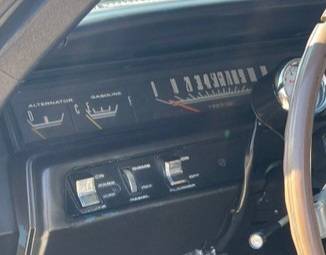

What's up with the lettering on the amp gauge where the C is over on the fuel gauge and the F for the fuel gauge is almost behind the spedo panel, and like DF said why is the amp gauge on full discharge.
