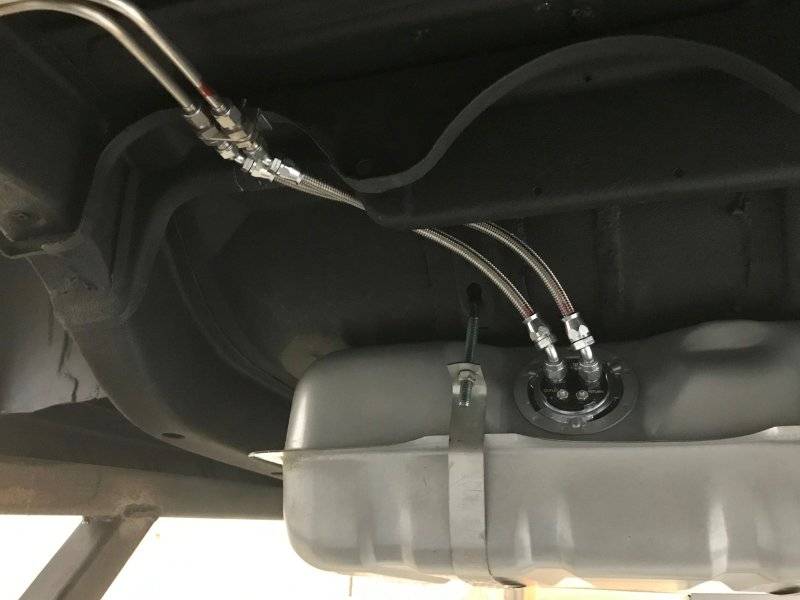

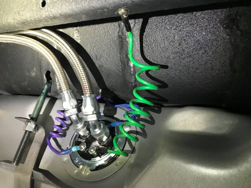

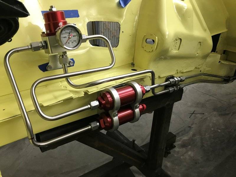

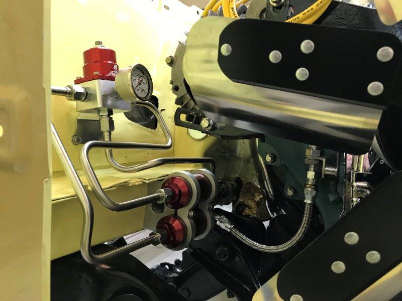

EFI here also. I took a hack from the modern and took two 3/8 SS factory lines to my local fitting/line company and they welded the appropriate fitting on the end of them and then crimped flex lines on the end of them and then AN fitting on the end of them to go to the throttle body and the pump and the return line. I ran the line the factory route and covered it with heat covering at the engine and over the tail pipe.

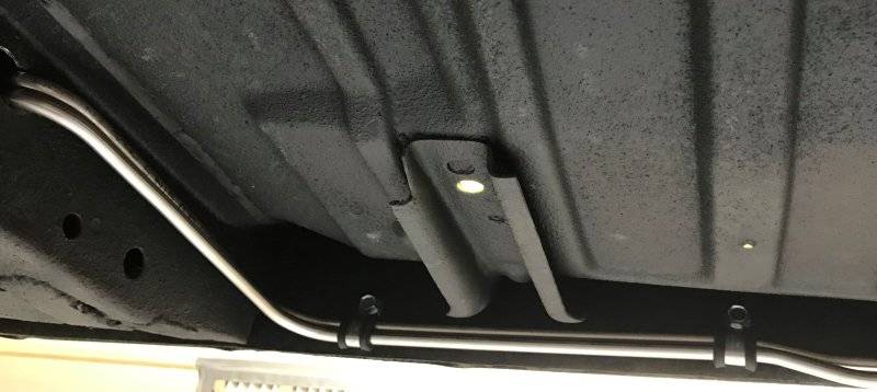

Ran 3/8 SS pre-bent pressure and return lines front to rear, only used short sections of PTFE for connections.
