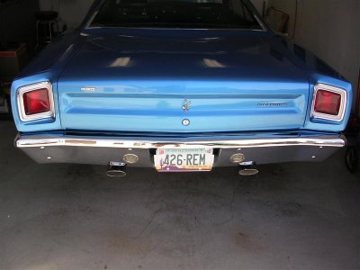

Hey gent's,
Finally getting the freshly painted bird back in the garage tomorrow and I need a favor. 1st off, yes...I tried the search box to find previous threads for this same info, no luck....but it did pull up 134 pages of other links..lol
I'm looking for a location for the door running bird sticker and one for the standing bird in the center/rear of the deck lid. I don't need precise measurments to the 0.000's, but a round about measurement would be helpful. Even a close pic without the measurement would help out immensly.
Thanks a bunch for your time.
If I recall the standing bird was dead center in the recess of the trunk lid, right above the lock cylinder. At least that's how it was on my orange car and the trunk had the original paint. Here's a good representation of the door bird seen in an original commercial http://www.youtube.com/watch?feature=endscreen&NR=1&v=YVEYV5Gbmq0 You can see it at :49 plain as day.

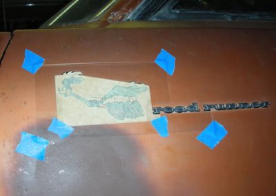

hows this?
Holy smokes Mark! Much obliged sir. Perfect! Thanks for taking the time to post all that.
Can you help with location overall, as I reskined my doors, and I need to drill the holes an d just wish to screw it up once. I too did a great many searches, Thanks for the close up ! Well done,

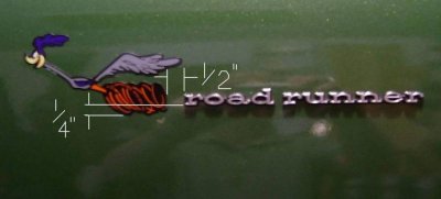

Is this what you're looking for skydiver? (Courtesy of FBBO member Funship)
