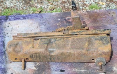

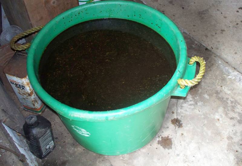

Next, I dumped it into a feed tub, and added four more pails of water. Most articles suggested 5 to 10 parts water, but I stopped at four simply because that's all the room there was.

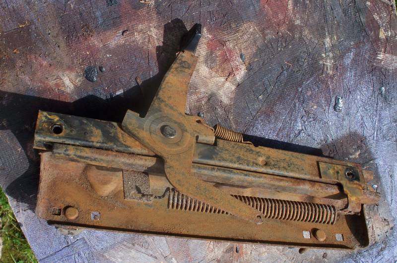

I had a couple of parts to test, so into the tub went a rusty seat bracket and a rear transmission mount, as well as a small pail of rusty nuts and bolts.

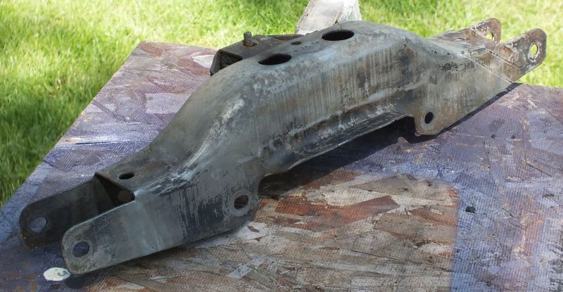

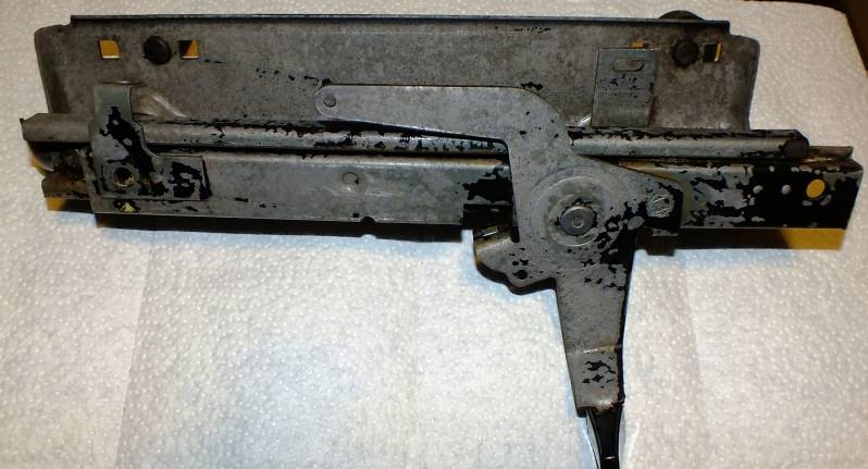

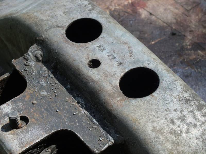

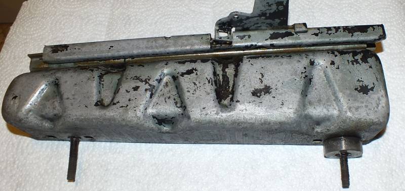

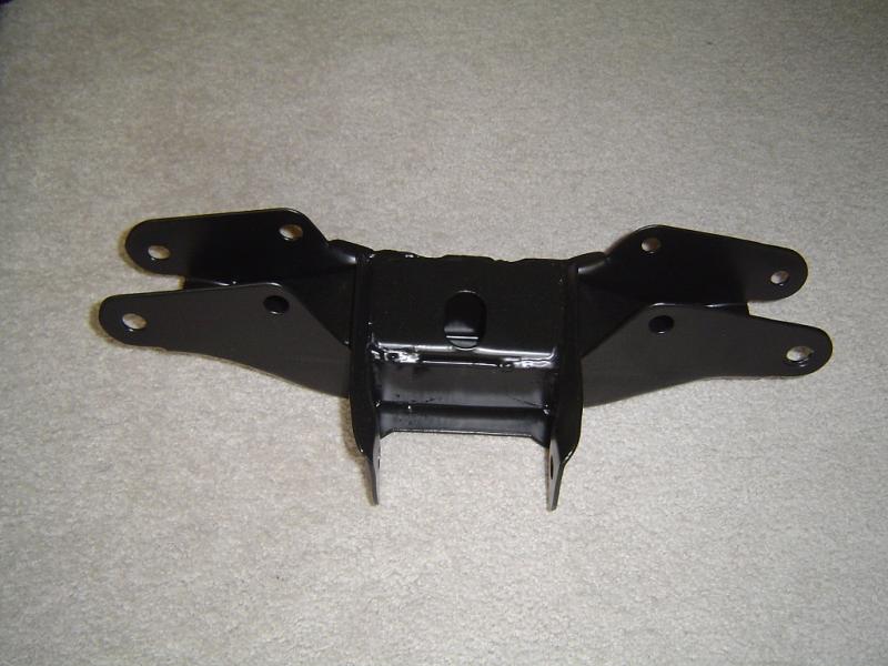

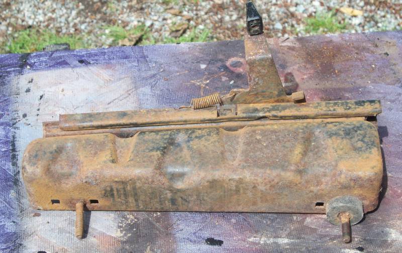

After just a couple of days, I did a quick check on the transmission mount and could actually see some improvement. I checked a few more times and took it out.
I didn't take before pictures of the mount, but you can see the after view in the first two pictures. The stripes at the right hand side of the picture are where the ears were sticking out of the molasses by varying degrees after taking it out and putting it back while checking.

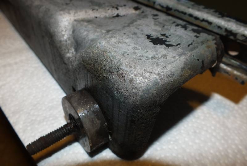

As you can see, the seat bracket is fairly clean. This is after close to three weeks, I sort of just forgot about it for a bit. It came out rather dark, what you see here is after a good blast with the garden hose, and then drying off.
All in all, I'm quite happy with the results, and still have lots of other parts to dip, as there's no indication that the molasses mix is slowing down.

By the way, I removed the springs before soaking to enable the track to slide back and forth. The small one was too rusted, and broke. The larger one turned out pretty good, but the pitting is still noticeable.

A further note, if you want to try this. Freshly cleaned metal rusts really fast. A couple of hours after I took those clean shots, the parts started to turn gold. The next morning they were brown. So a wipe with muriatic acid was in order...
