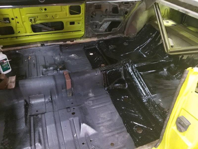

Fix the leak first then thoroughly let it dry in a heated garage. I agree with YY1, an encapsulator like POR15 or Rust Bullet is another option.
POR15 on the Floorpan of my Coronet.
My 2-cents. I agree with YY1 to wire brush off as much as possible first, then you have 2 options. You can dissolve the rust (naval jelly/rust remover) or react the rust (Rust Mort/POR 15). I normally react the rust BUT if the panels are brand new, then I would probably remove the rust instead. The rust remover will eat away more at surrounding good metal, fyi.

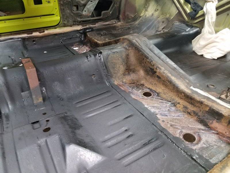

I’ve used por 15 on a couple cars. Worst rust protection ever! I think it actually promotes rust.
What I do with that is, brush on Ospho, Evapo Rust or Phosphoric acid on the area. Cover with a plastic sheet so the solution does not evaporate. Every 5 or 6 hours brush again, then cover. Keep doing this and within a couple days that rust will be dissolved. Key is keeping it wet. You'll then get back to silvery metal. Been doing this for years.
