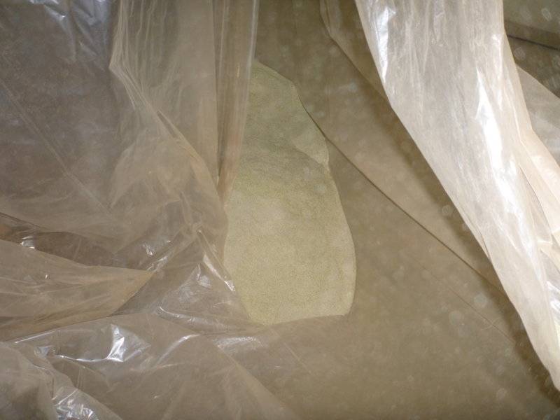

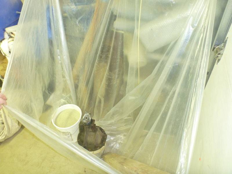

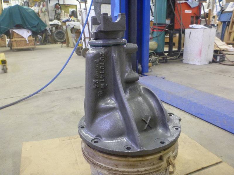

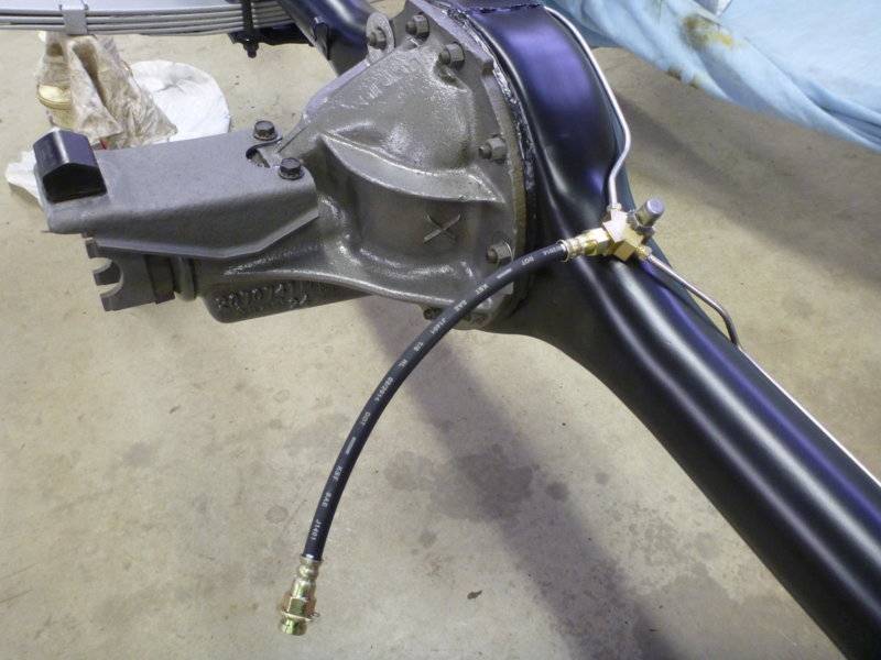

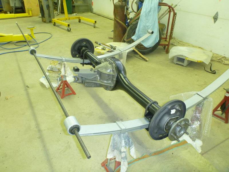

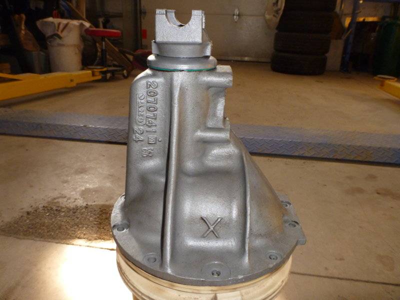

How I did my pumpkin as too heavy to put in the cabinet and need the pail to seal the glass out of the gear side. Shipping tub liner bag, but you could use a tarp with some folding.
