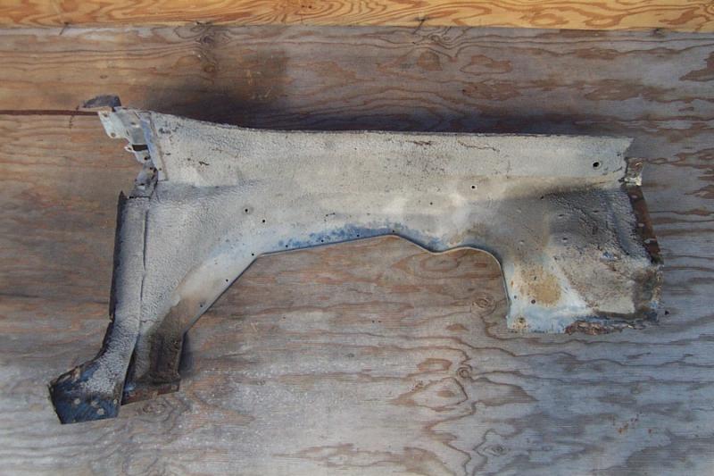

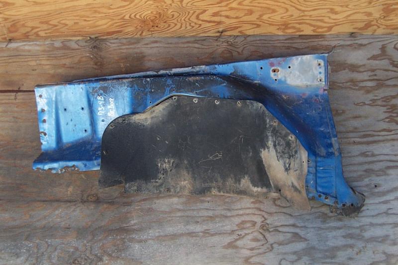

Heres the BB fender well
Those are great photos of the inner fender wells moparmarks.
wish i had them those pieces before i made my cutout.
Thanks ralph
ohmyholyhell!
I had a 74' with a 400...I forgot how much of the inner fender was cut out! I would think that would be a big weak spot for the front end with that much cut away...again, wow!
