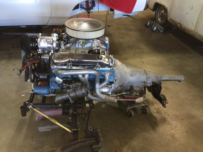

Here's a photo of my 400 with Schumachers attached.
