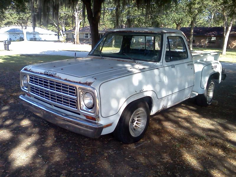

Running, driving 1980 D150 step side.
Pics to follow, as it was dark when I got it home.
Was slant and manual on the floor.
Cab is shot but bed is almost perfect.

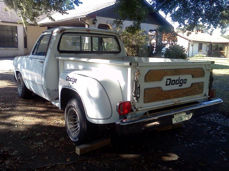

Has turbine style wheels and came with Red Express stack shields and tailgate wood.
$800. Sat on CL for two months.
Had to jack up motor and install starter in sellers driveway to get running.

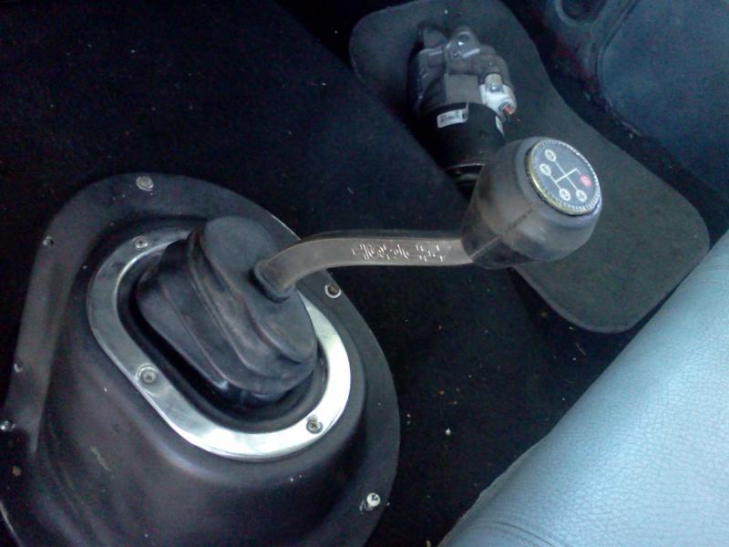

Could this be an O/D trans, and original to the truck?
The case looks like it might be aluminum.
It has B/E body shifter mount locations with an adapter that puts the shifter an inch up and an inch ahead of the rear mount.
Sound like a truck trans? Useable in B body?
Shift pattern on knob shows reverse extreme right and down, but it's really extreme left and up.
O/D?
The knob is off an NP435(granny tranny), if it is an aluminum case that has external levers, its an O/D trans (if actually a 4 speed). The slant trucks came with the O/D, I believe always in those years. As for interchange, ask Jamie Passon, or Brewers.
From what i can remember about the o/d transmission, The case is aluminum, the tail shaft housing has 2 shifter positions available but the rear most place is usually not drilled and tapped, the o/d gear position is where the 3rd gear would be on the non o/d A883. Most folks reverse the shift lever rods so that the o/d position is where 4th gear would be an a regular 4 speed. This can get confusing because all the guts from a o/d trans will interchange into the cast iron case and visa versa. There are a few different front bearing retainers as well as bell housings that have a different hole diameter to accept the retainer. I don't see any problem with the o/d as long as you don't over power your engine. The thing to remember is the o/d gear inside the transmission in in the same place as 3rd gear is in the regular 4 speed so when you are in o/d gear you are transferring power through the entire gear set as opposed to the 4 speed that is transferring power strait through the imput shaft to the output shaft.

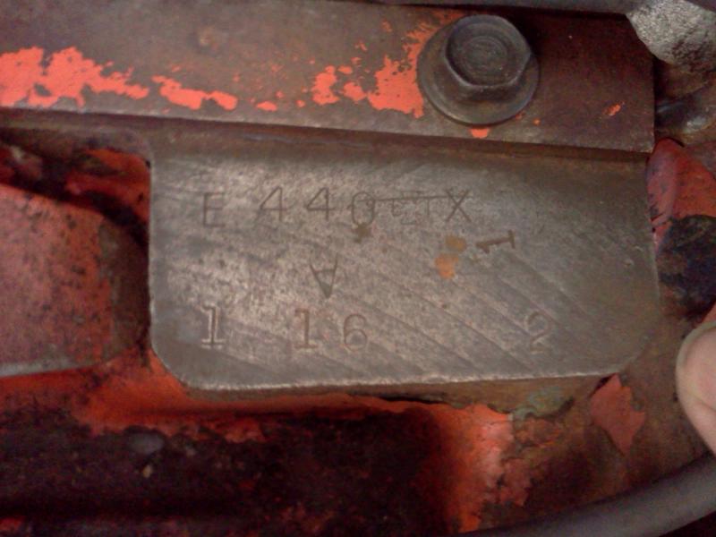

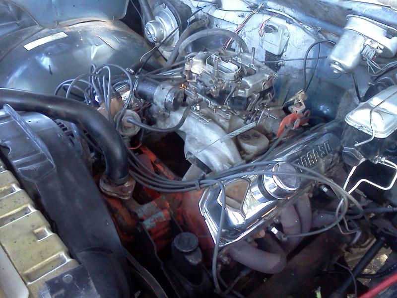

Looks like a .010 over and .001 under motor.
