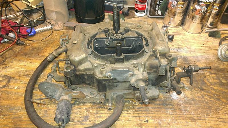

Post a pic of it from the front. 1 3/8 primaries is an 800 1 1/2 is an 850. It should be an 850.

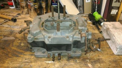

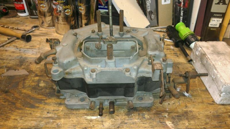

Sorry to hijack but...would one of these two be better than the other?? they both have 1.5" primary. I never knew they were 850 cfm. thanks

Throw the bottom one in the ditch. Save the center section though.
Agreed - use the top model.
YY1 - I would disassemble and clean it and install new gaskets. A basic bench rebuild. There is plenty of diagrams and info on the Tquad out there online if you get lost.
If you have a pretty stock engine producing good vacuum it should work fine. I have one I'm itchin' to try on something. The plastic bowl may be the answer to keep this crappy ethanol spiked gas cool enough so it doesn't evaporate as fast (hence the name).
The bottom one is best used for stock to very mild modded engines. That gizmo on the upper front is to adjust the fuel mix for altitude. Very handy item on the dead sticker that actually travels around.
Save it complete and cover it.
