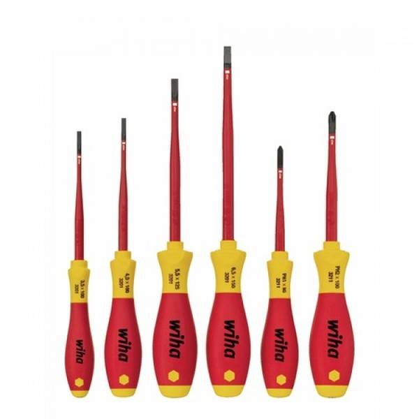

I use WIHA electrical grade screwdrivers - but the most important thing to remember , especially when using Philips screwdrivers is to use the correct size.
Blazing into a screw with the wrong size will munt the screw and make the job of removal more difficult.
Trust me, I'm an Electrician. :)

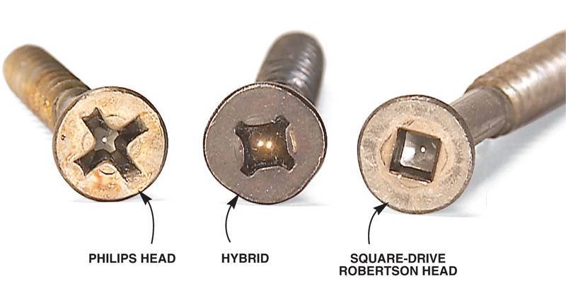

Also....do not get confused between POZI heads and PHILIPS heads....another fatal mistake that people make.
The best screws around for durability are the square drive variety.

We build/sell tool kits for the military and have seen them all. The German made are the best. Witte, Wiha, and Wera. I prefer Wera as they have a great selection of sizes, both with handles and loose bits, ratcheting, electronic, etc. For insulated 1000v, I really like the Wiha, they have more insulated items available. Most everything else is made in China.

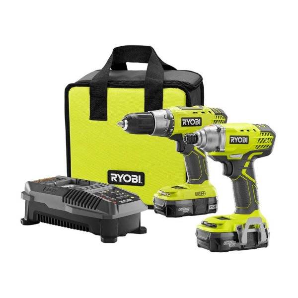

I used to use a impact driver on stubborn Philips screws ( the kind that you hit with a hammer).
I was in the market for a cordless drill and saw this set at Home Depot that came with a impact driver.
https://www.homedepot.com/p/Ryobi-1...-mobileweb_pip_rr-_-205885687-_-207092155-_-N
I want to tell you that thing really works great on breaking Philips head screws out without destroying the head. When installing screws in wood, they haven't got a chance, they go right in! It all has to do with the "hammer action" that impacts the screw. I've removed numerous screws with it that would have never even budged trying to remove them by hand. I have a 3/8" socket adapter that I use with it also. It sure saves my RA effected hands from any flare ups!
