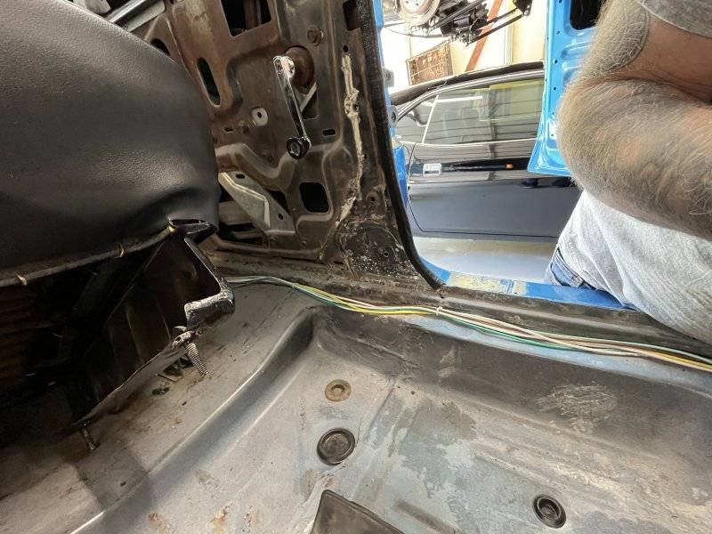

Did you ever het the answers you were looking for? I have a 68 Charger and 3-point belts ready to install. I need a couple things. I don't think the shoulder belt provision is in my roof. Also The new floor pan/rockers do not have the outer anchor point. I need the measurements to add it
