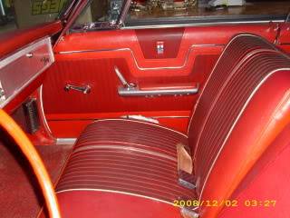

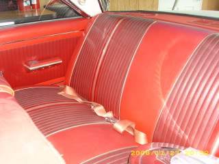

Anyone know where i can find repo seat covers like this? The back seats look brand new, but the front drivers side has a huge tear and the original owner glued a pad over it.. Not sure if any companies carry this or not, just thought i would check here first.. Any suggestions?

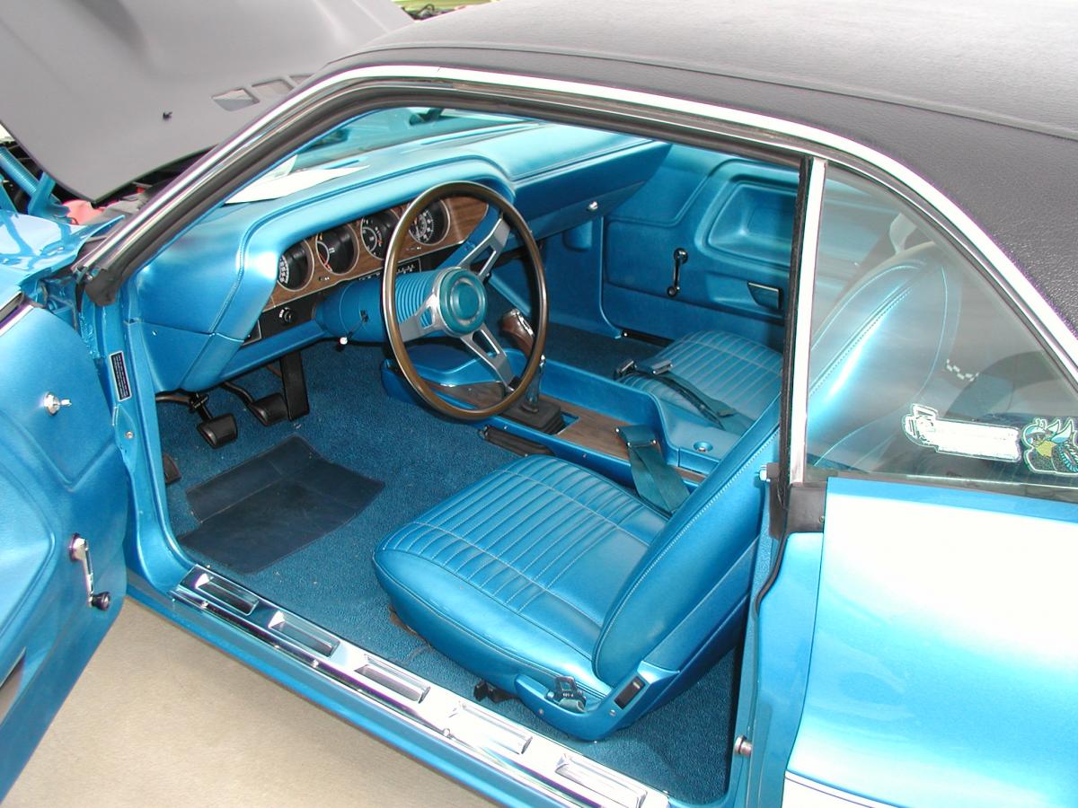

Not necessarily. When I still had my Challenger it had the original seats in it.....bright blue. And while forcing myself into it (in the trailer @ one of the races) I popped the insert on the driver's seat. I had a really good contact in Legendary at the time and got a piece of material large enough to have a new insert made. The only way to tell it wasn't original was by touching it. The new was much softer than the original, but the color was dead on
