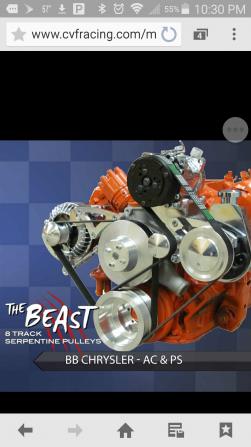

Finally installing the long waited A/C which means time to sort out the pulley setup. After thinking about it I've decided that it makes no sense to stay with the v belts when serpentine is far superior so now the question is how? I'm considering making my own but having little time might just buy one. Here's one I like, wish it was a single belt with a tensioner but it's priced fair (in comparison) and is an 8 rib. Any suggestions????

The cvfracing one looks to be pretty decent price?

When I was looking into the serp setups the CVF Racing reviews were way better than March. For the price can't go wrong with CVF I just hope they can do them in your preferred finish

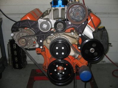

I'd like to learn a bit my about SD Concepts, they make a true serpentine kit using standard parts but I'm having trouble finding any pics of their new billet setup. Feel free to post the slickest setups you come across.

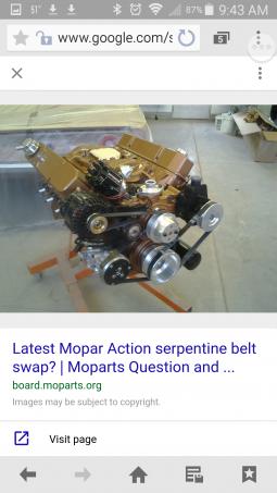

I'm so digging this setup, not a single belt setup but the cleanest I've seen yet with the A/C mounted down low. Time to track down the brand and hope for a decent price.

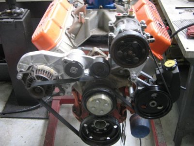

I believe these are pics of the SD Concepts serpentine setup. If I'm reading correctly it's pretty affordable at $550 but requires a different alt and power steering pump? Their website is under construct so I'm waiting to hear from them. The kit pictured I believe is their old one mostly made out of reworked parts but they now offer billet????
Not as clean as the other and a bit clunky looking but an honest to goodness serpentine robbed off a modern car.
I better add before someone notices...... yes the water pump turns backwards. According to SD the pump works perfectly normal in reverse provided you have the right straight vane pump.
Can anybody tell me who makes that slick setup that mounts the A/C pump down low that I posted? My labtop is down and the smart phone is a real pain sometimes. Thanks

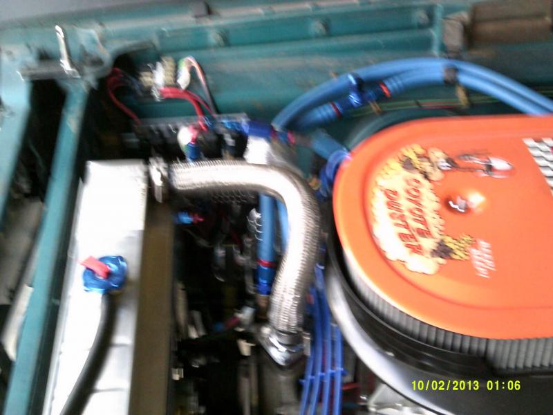

I have serpentine belts on my 68 RR too,
I bought individual pulleys that fit my need
from March Industries, got them from Magnum Force Racing,
I have an electric water pump {& fans} only run an alternator & a power-steering pump,
I made a idler bracket out of a 1/4" piece of 7071 Alum.
I mounted it off the water-pump front top right & got the idler pulley from MFR too..
I didn't like the looks & bulk of the kits & 1 belt designs,
I had to do some shimming & altered spacers off the alt. &
for the power steering to line up, the Pro-Sport 7-1/4' billet steel damper {Mancini Racing},
I would have had to do custom shims either way, it's a weird thickness...
I like it much better, it's far lighter, no power loss, really quick rev.'s & no belt throwing,
IMO much better than the V-grove OE stuff too...
Simple easy deal, not a big heavy expensive
{I don't care about price usually unless it doesn't add any performance benefits}
& really fugly/bulky bracket hanging off the front too...
If I am to replace something, I want something better & performance oriented...LOL
sorry about the photos they are really old & they suck,
but only ones I have at the moment...
wasn't planning on really sharing them :poke:
