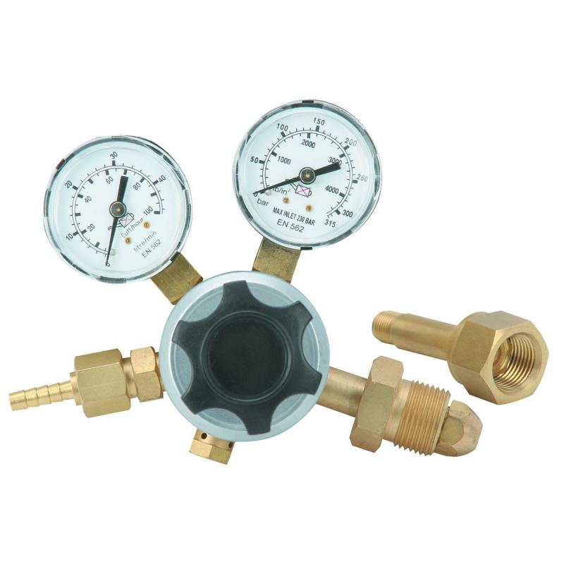

Where should I have the pressure regulator set on my new Mig welder. Right now it's set to Cubic Feet per Minute
Argon 11 Co2 10. Is this good. Thanks
The flow rate is in cubic feet per hour.
I set mine in the range of 40 cfh.

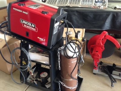

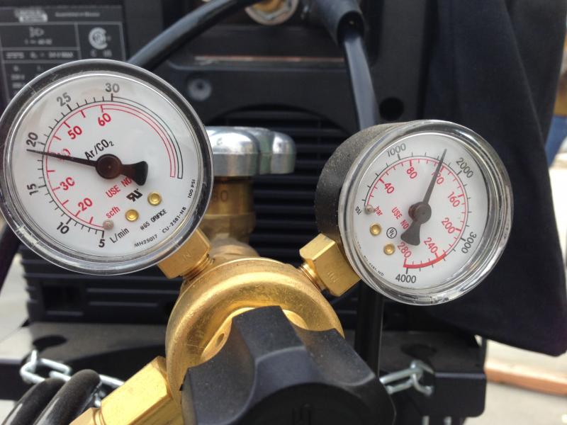

This is my GAGE set-up :
NOTE: the Arogon/CO2 mix Gage is CFH (Cubic Feet per Hour) A Flow meter
The pressure gage simply shows how much pressure is in the Bottle (The more pressure means the bottle is FULL)
