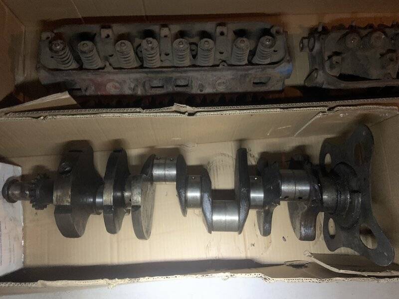

I picked up a 4006630 440-2 8T E HP block standard bore.
Also got, a forged crank, LY rods, 906 heads, stock Chrysler 4 barrel RB intake, harmonic balancer, water pump, push rods, and main bearing caps.
I paid $500 for the bundle as a rebuildable core disassembled. The cylinder walls look good. I’m hoping it can be bored 30 over to save some boring capacity for future rebuilds if need be.
1. Did I do okay on the price? I didn’t have to pay for fuel, so I considered the savings a bonus.

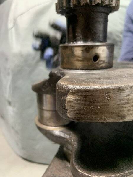

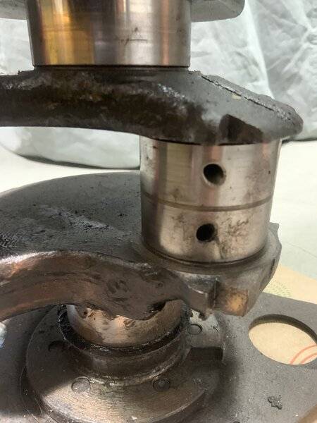

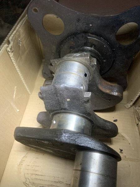

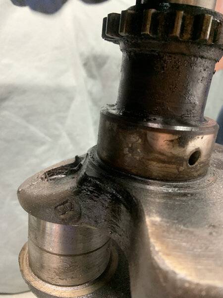

2. The forged crank doesn’t have a casting number. Can it still be a real Chrysler forged 440 without casting numbers? Me and my dad figured there are no castings because it is forged. It only has these stampings that I have seen:

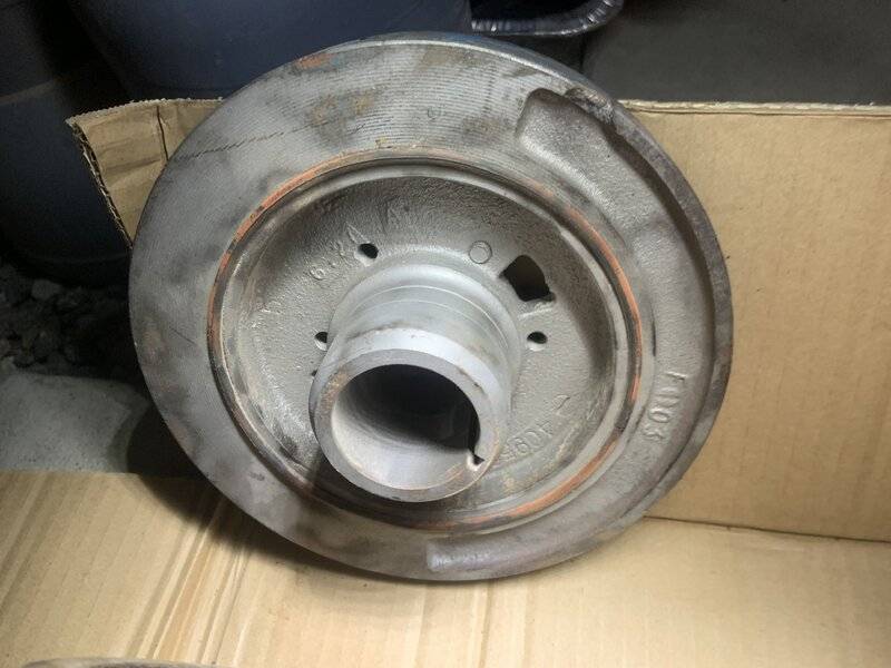

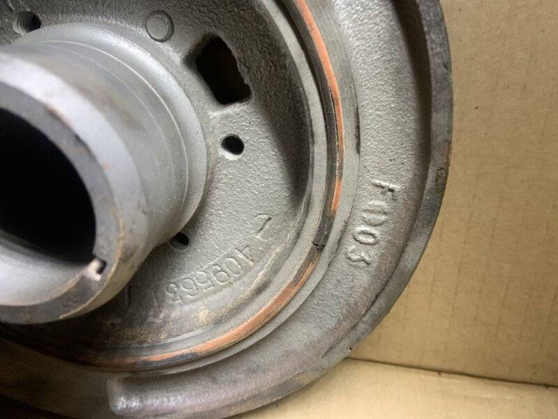

3. The seller threw in a harmonic balancer, but I believe that it is not correct for a 440. Anyone know what this balancer goes to? Casting number is 4095631. Could it work with my forged combo?
4. Being a cast motor originally, are there any modifications that need to be done to switch it to a forged crank besides taking care of the balancing issues?

Also in a big block Mopar book by Don Taylor that I have, it says that I can identify the 440 crankshaft by measuring the small main bearing crank journal. It should be 2.75 inches. Anyone know how to do this?
Next stop is a good machine shop to have everything checked. Bore as little as possible. I don't know the availability of pistons in less than 30 over, but the machine shop can tell you if it needs boring at all.
Definitely a factory forged crank, which means you can't use that balancer, it is counterweighted for a cast crank. I would expect to have the crank ground.

I don’t think that I would use that balancer with a chunk broken off of it and the elastomer ring appears to be separating.
Just pop for a new balancer best thing you could do. I would never put an old one on and refreshed motor. We went 20 over on a stock bored 383. Could not find flat top piston's. so put half dome in the motor. What head's do you have. If you have the 906 head's their is room. Your engine shop should be able to tell you if that is an option.
It's not a steel crank damper. Get a new one. The motor price seems good for today. An .030 bore should be good. A quality machine shop will tell you what it needs.
Don't think any of my 440 cranks had casting numbers. Stand it on end, with no damper bolt, tap each counter weight with a hammer, listen to see if it sounds like a tuning fork. I they all ring like a tuning fork, the steel crank is good. Then just get it ground to the size that works.
Yes, cast crank balancer, but would tell you to get a new one even if it was for a forged crank. New ones are not expensive and now is the best time to replace it instead of later when you have to also replace all of the other stuff that got damaged when it came apart. One thing I picked up on from your question was this,

Thanks for the reply Jerry. You are correct. Next stop is the machine shop. I have seen Keith Black pistons that are 20 over. I am thinking 20 over to leave myself with more boring potential in the future.

Thanks for the comment. I thought it the balancer was not correct. Thanks for confirming the forged crank. I am going to borrow a friend's caliper soon to measure things out. I am definitely going to have the machinist look at the block etc. because I am no expert yet.
