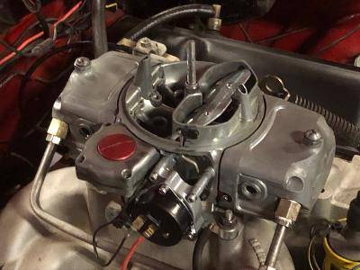

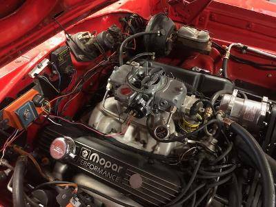

The Charger starts and runs great BUT when I went out for a drive today, I went through some areas with fairly steep grades. On level ground and going up, the car acts normally. Going down hill, the engine wants to stall. I had to pop it into neutral and rap the throttle.
I'm guessing fuel level in the carb but they both looked fine the last time I checked.
It is a Barry Grant Speed Demon 850 Vacuum Secondary carburetor. I have a regulator with a return line to the tank. I get no vapor lock with this setup.
Maybe 15 to 20 degrees.
It shouldn't have a problem at that angle. I suspect that you are getting more fuel than air. Check out the floats. I had a 66 Bronco years ago and ran a Holley carb on it. I had similar issues but on more severe angles. I modified the carb with vent baffles and the vent hose trick. I would never run a Holley on a 4x4 again. I ended up swapping it out for a Carter and never had problems again. A Holley will get you down the quarter mile quicker but if you are not on flat ground they are notorious for flooding and stalling. It's the nature of the beast. I know you are running an electronic fuel pump. What fuel pressure are you running?
It is actually a Carter mechanical that was pushing around 10 psi. I use the regulator that allows approx 3 psi at idle with a 7 psi max.
Sorry to confuse you. I was referring to my Broncos carb but the basic operating principals are the same for float level. I would pull the bowls and check the float height and for any debris or obstructions. It sounds like its flooding and when you are pumping the accelerator you are giving it the air it needs to keep it from falling on its face. If you had an air fuel ratio gauge it would verify this. The power valve rarely blows on your carb model and your only problem is at angle so I would rule that out. I think your thoughts are headed in the right direction in this one.
My first thought was the float levels....but I have another thought that it might be the vent tubes in the tank - crossed over, and not allowing the breather function to work...creating a vacuum in the tank. This would become apparent on a long downhill or steep continuous climb.
I know a symptom of vent lines crossed over is the smell of gas in the garage, and vacuum condition in the tank....worthwhile checking it out. There could also be an obstruction in the vent tubes on the tank, but that should cause a problem on the flats as well.

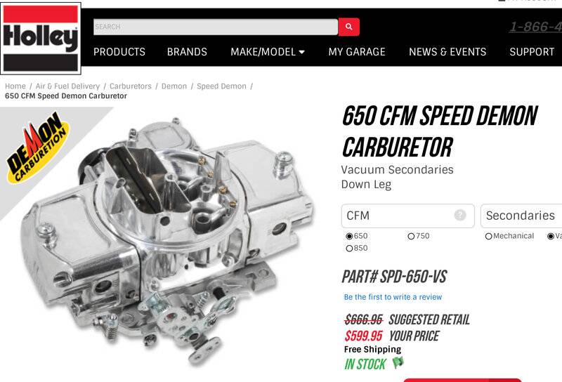

That carb has no business being one a Mopar IMO. Sorry, I’m not a Holley fan.

If they were better than holley,,,,,,,,,they might still be in biz.
One must place that squarely on the management and oversight. Holley must have thought there is a market or they wouldn’t still be manufacturing them?
I personally have had more issues with Holley carbs poor materials dating back to 1973 than with any BG. I still run one on my RR.

You ended up with my Demon! Get efi. Good on hills just pisses fuel from surging after shut off. We have choices.
