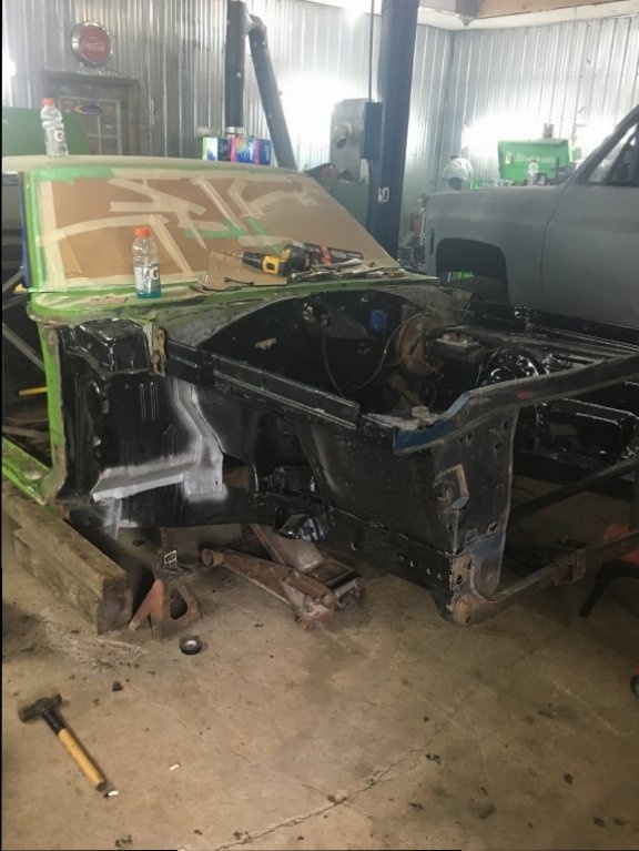

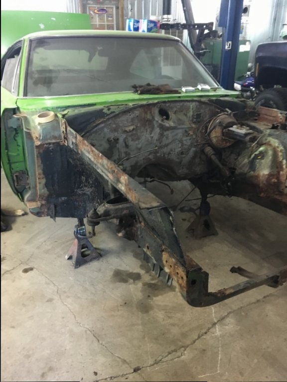

Haha that's great, I thought I was the only one crazy enough to take on one like that! Looks just like mine!!

Nicely done great work! keep up!
You work on it all day long or every night? Cause I find that you are going pretty fast that is good!:thumbsup:

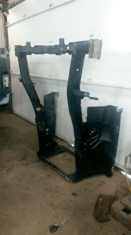

That's nice work. The doghouse was the first thing I replaced on my GTX. Frame rails rotted through and inner fenders all cut up. I figured if I butchered it too bad and had to scrap it, I wouldn't have much time devoted to it lol.
at the rate he is moving,it should already be painted
and he should be buttoning up the engine about now!..lol
Haha I try guys! I work away so I am only home 2weeks a month! So I give her **** when I am home! My wife and kids are awesome helpers too! I will be back at it in a week, should be done soon bahaha!
