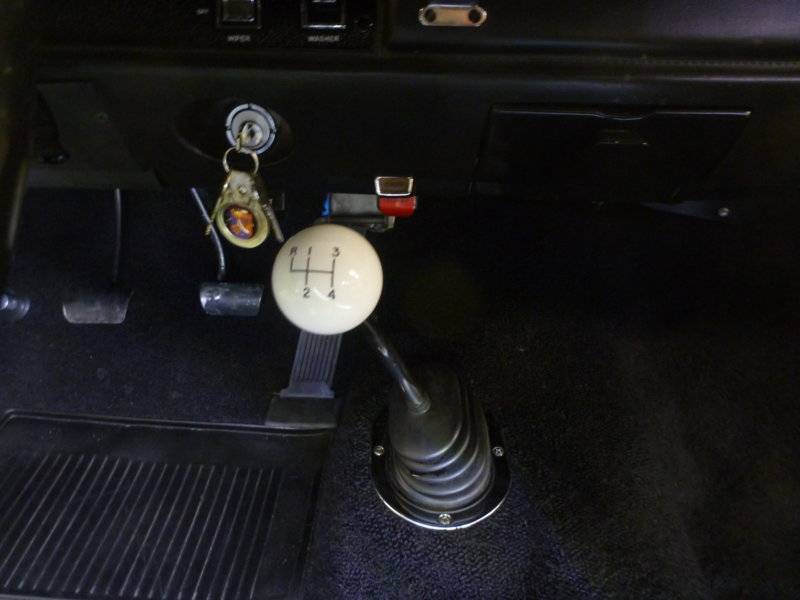

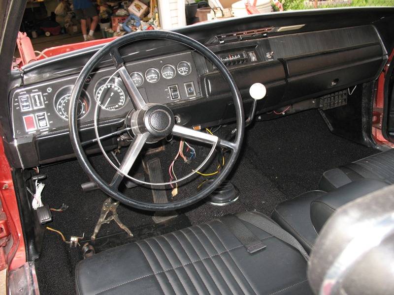

Just like it was went new..... Back in the day we would unbolt the shifter, elongate the bolt hole to allow the shifter to roll back a little & reset the linkage adjustment to compensate.... An upgrade would be to weld up the back edge of the elongated hole so the shifter can't pivot back to the original position...
The other method is to heat & bend the shift handle..
Oh, and the early 68 sliding ash tray worked better than the tilt out ashtray with a 4 spd..
OE '69 shifter handle is a slip in.. not bolt on. Believe '68 is the same.. no?
How do you always answer questions so quickly, with pictures? No matter what the answer, thanks for the quick reply. It is near impossible to compare photos taken at different angles, but if you look at this one, even with your picture having the boot down, it looks to me that my linkage in reverse is tilted a lot further forward than yours. I really like the style of this handle, and correct or not, would like to make it work, if possible.

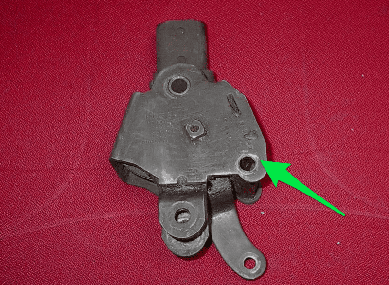

In 68 the shifter was well known to hit the dash... They may have corrected it in 69 or even mid year 68 but 68's are definitely known for the issue & it's why the sliding ashtray is somewhat sought after...
FWIW the hole to elongate has a green arrow pointing at it..

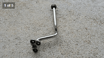

I thought the 68 b body had this shifter.
Yep, '68 would have been the (in)famous "Inland" shifter, not a Hurst.
Those didn't come along until '69 - and they would have been the "slip in" type, as has already been
mentioned (2-bolt came later on).

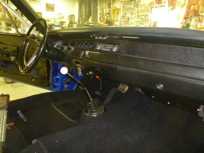

I've got a vintage (yet new!) Hurst Competition Plus shifter in mine (2-bolt). Doesn't come close to
hitting the dash (and yes, I have the early-year flop open ashtray).

I would call & ask but he passed away about a week ago... Anyway end of the day elongate the one hole & rotate the shifter box..
