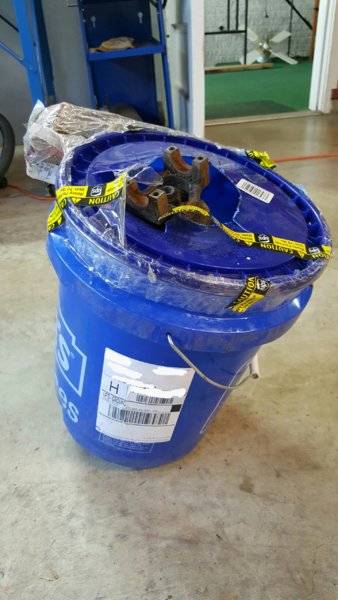

I used a heavy duty plastic box from home depot. It was like 10.00. Then wraped the chunk in plastic put in 5 gallon bucket and filled with spray foam. With everything in tub tape up the lid, tub even has handles. With my ups shippers account it cost like 50 buck to ship. Anyone can sign up for a shipper account with them. You get a discount off the top and they seem to always have a 40% off code. For the box look in the moving supplies section at Home depot.
Been a few years now but having an account with UPS didn't much matter on the price. Maybe it does now but in order to get a good percentage off retail shipping, you had to have a commercial account. I may take another look after the first of the year and see if things have changed. I quit using UPS because they were upcharging with nearly every shipment due to weight and that's one of the reasons for me to quit using them. Even adding 5 lbs to each shipment didn't help any and my scale was right on with the one at the USP drop off store and I even checked my shipments with both of their scales.
