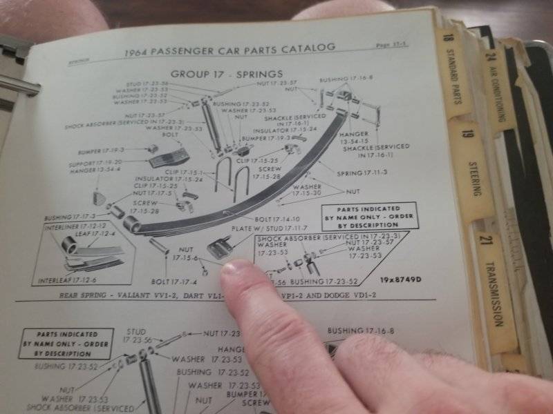

Hey everyone,
I'm looking for a left shock support bracket with the stud off an early b-body.(64 Dodge Polara) I broke the stud off of mine trying to remove the nut. Any help is appreciated.
Mark H.
You can cut the remaining stud off flush with the bracket, drill it out and use an aftermarket shock stud, either weld on or bolt on. Not hard to do.
