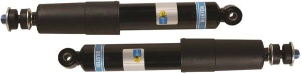

pics? look like regular shocks?
I'd suggest KYB from James @ PST or Bilstein shocks. Air shocks? Uh, no in my opinion
Here is an example.
Same one's I have
