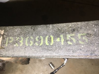

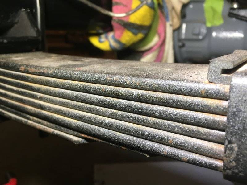

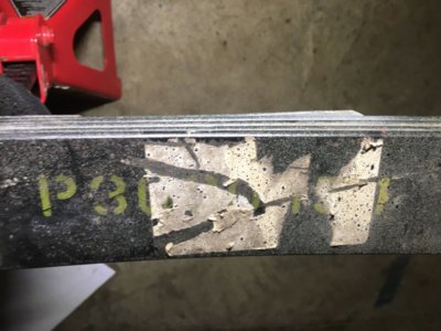

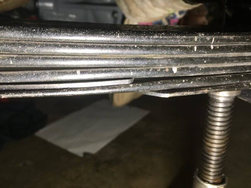

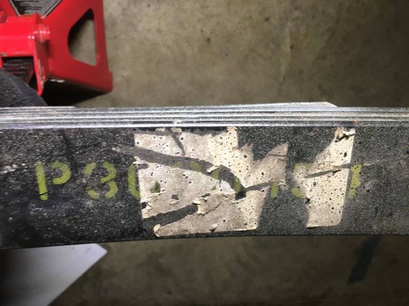

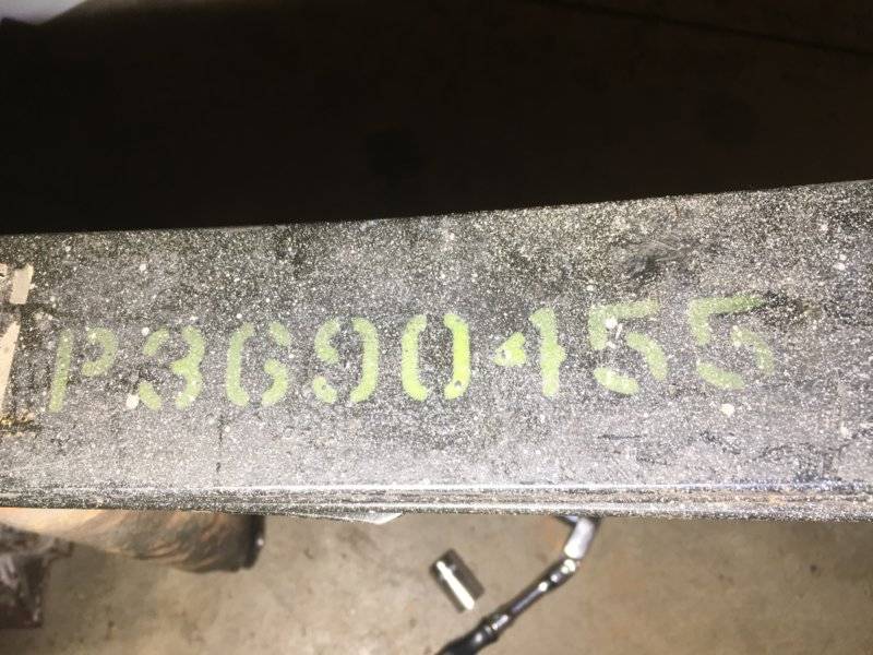

Greetings Houle,
Here are the numbers on my Springs. Sorry the right side is not legible but the part parts book shows the right: P3690-454 & left: P3690–455.
I have seen suppliers use different numbers, but they all seem to keep the last three. Which is why I put the dash in there.
Hope this helps.
Left: 2EEA4153-4931-4FE8-BEAB-E26EC43C6863.jpeg 8D608F4A-0045-479B-A9B0-06B7085E5EB6.jpeg
(R has one extra leaf as shown) Right: 7F03D205-B89D-4921-8F76-3E817B106A9B.jpeg B669E311-0821-4078-A987-226FD6C697A2.jpeg
