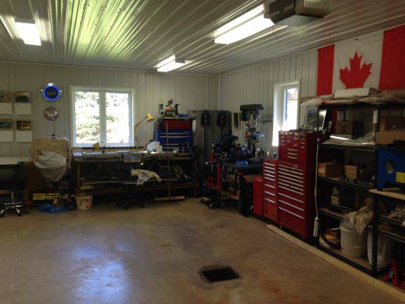

Well I had bent back and forth between drywall, OSB, or metal panels. Ended up choosing the metal panels. One, they would save thousands of pounds hanging from the structure. Second, once they were up they were up. I didn’t have to go back and mud, tape, sand, paint, etc. So far I’m pretty happy. I’ve mostly been working by myself, and working in a full garage adds to the difficulty. I went with menards pro-rib bright white. Can’t wait to get it done, what is up looks great.

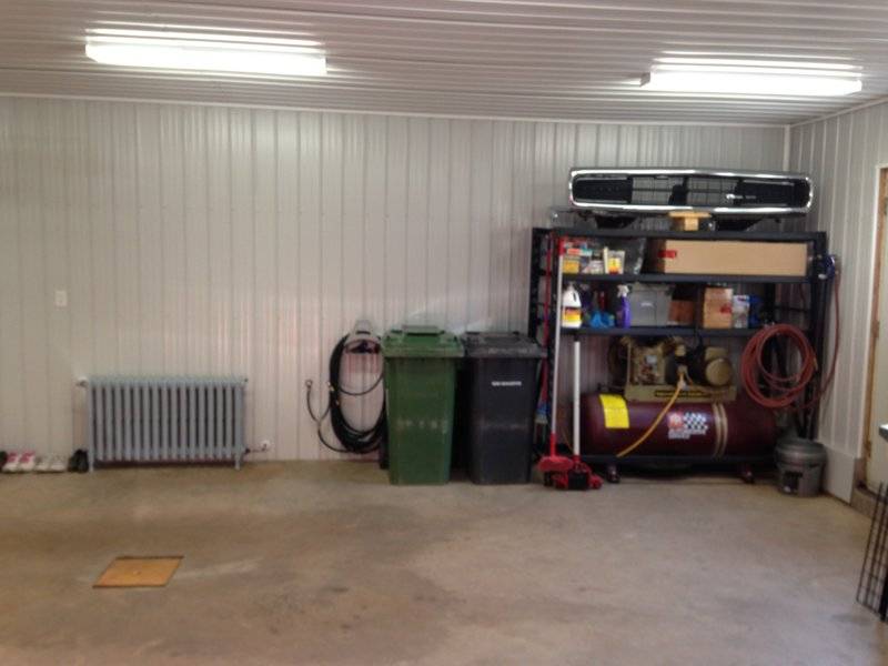

Same here. Looks so clean and brightened the place up so much. Didn't hurt that my son works at a the metal fab plant where ceiling and side panels are bent to shape. Plus your right. Relatively easy to work with if you know how to run a grinder and measuring tape. As you can see by the rad. No sweating problems.

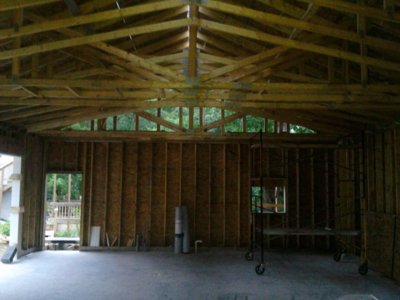

Has anyone installed theirs upside down?
That's the plan for mine...Rather than having the ribs stick down mine would be facing up and the flat areas will be facing down.
I'm only using it on the scissor truss areas so I'll be able to do the install with no seams.
Planning on installing the 2x4 flat led light fixtures (7500 Lumen) under the steel.
R-38 above in the truss's.
It should make for a nice job when it's finished...
