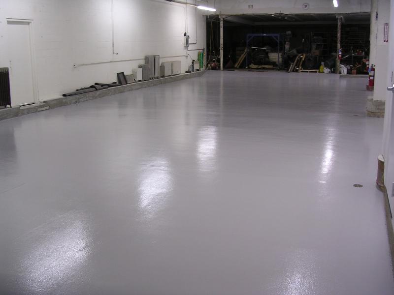

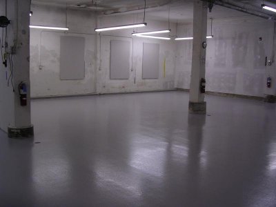

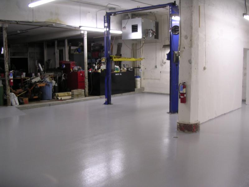

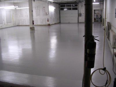

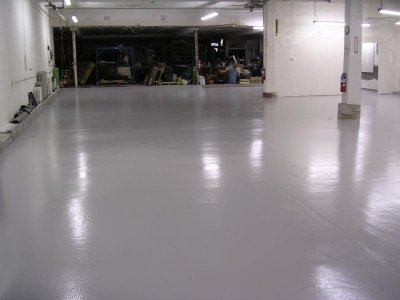

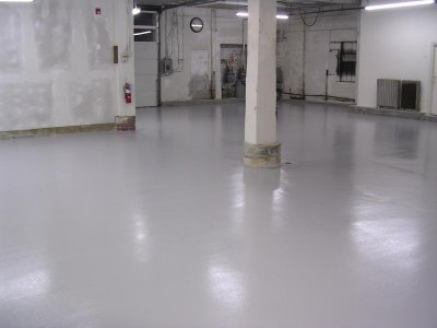

My experience is on the other extreme end. I had mine done professionally. It took a crew of 3-7 people at least four days. Not cheap and I wouldn't recommend it to everyone.
First they shot blasted the cement. Fixed some imperfections. The first coat was called an epoxy mortar. I remember it was a full pallet of just that. Before that dried, 4500 lbs. of sand was broad cast on and into the mixture. The next day, they swept and vacuumed the sand that didn't adhere to the wet coat. Then a layer of epoxy. The final day was a layer of something called poly aspartic (sp?). The whole thing is about a 1/4 inch thick.
I do love it, cleans up very easy. Most of my vehicles leak something, so it's really convenient to just wipe up a stain. I've spilled (well, not me, but a friend) at least 10 gallons of waste oil on it once. A squeegee and dust pan picks up almost everything, then a rag or two finishes it up.
The only thing I'm not too sure how to fix if I even do at all are scratches. Touch ups or recoats I think are going to be a process that I can't do myself.
If you use a system that you can do yourself, then that is not a problem.
