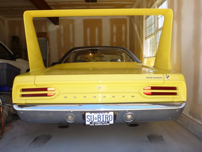

          Bird has it's stock 489 in it, that is a cone I'm sure, and it still works just fine 51 year later. Bee has a 741 in it out of a 67 Charger that's a clutch.. also working fine after 53 years. I suspect someone on this board must have a stock rear axle assembly in their spares hoard without blowing the money on new.

              RED X on rubber marks on garage floor! :lol:

              Was the Wife.. true story! LOL
