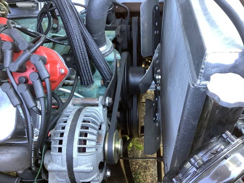

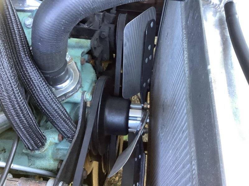

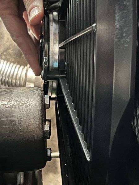

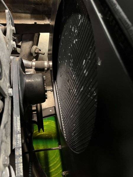

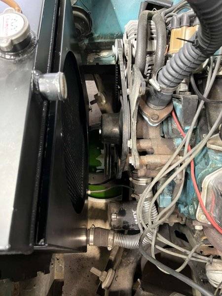

OP should post pictures!!! might be simple as a thinner fan spacer.
Had parents take pictures since I won't be back home until Friday. This is what I'm working with. If anyone wants to see more just ask.
