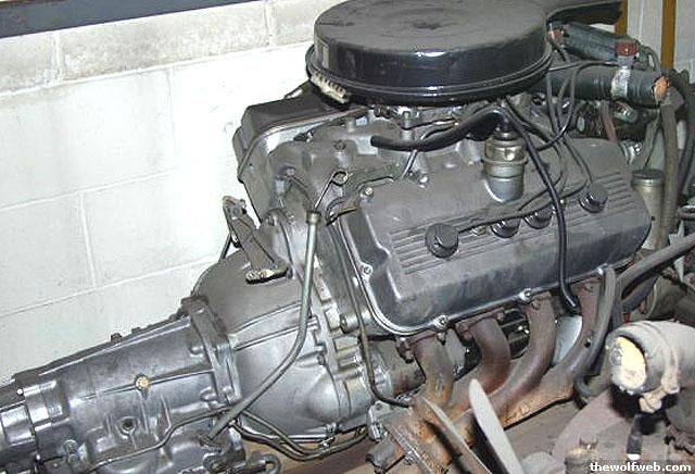

Toyota made a Hemi V8 for the foreign market
I don't think any made it here unless imported specifically
I don't know any of the specs or dimensions, you could look it up
I saw one in a Morris Minor way back when,
looked like a gasser vibe, Car Craft Sacramento IIRC like 1982-ish
it was tiny version of a Hemi V8
fit the lil' car pretty damn well, looked pretty sharp too
