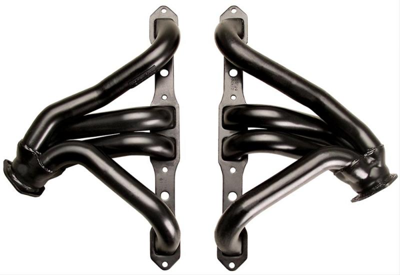

I did have a set of shorty Hedman Hedders #78070 painted like $179 from Summit IIRC
on a stock 383 in a 68 RR, BUT they helped the performance some, how much I'm not 100% sure,
I'm sure more HP/TQ than the stock HP manifolds, far less reversion,
better flow if nothing else would bump it maybe 10% on a stock type combo "free flowing"
BUT so did the 770cfm Street Avenger, RPM Intake,
K&N Filter & 1.6 ratio Crane Ductile Iron adj. rockers,
hotter ignition & coil, low ohm resistance wires etc.
The Hedman Shorty hedders I had, they have 1-3/4" short tubes like 20" long & 2.5" collectors

  • Exhaust Hedman Hedder Shorty style 1.750 inc tubes with 2-5 inc collectors hed-78070_xl.jpg
