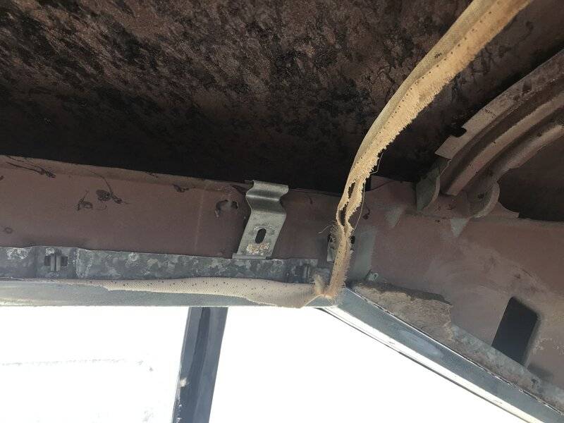

Does your car have the side coat hooks, you may be feeling that bracket.
This is from a 66 Satellite, with the bracket for the hook.

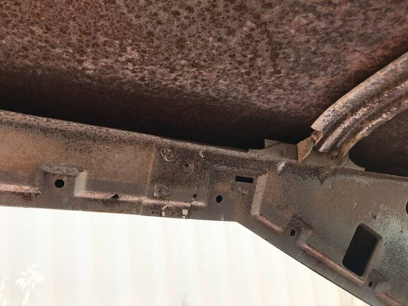

This is the same area from a spring built 67 Belvedere II.
I don't see where there is any provision for a shoulder belt mounting.

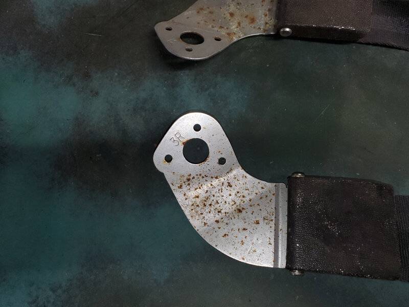

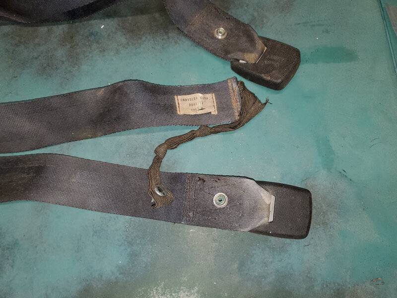

Well I am going to have eat my words. I have the straps for shoulder belts that came with the car, but no way to mount them. They were removed with the headliner when I got the car.
What is the date code on those belts?
I bet someone thought they could just bolt them in.
