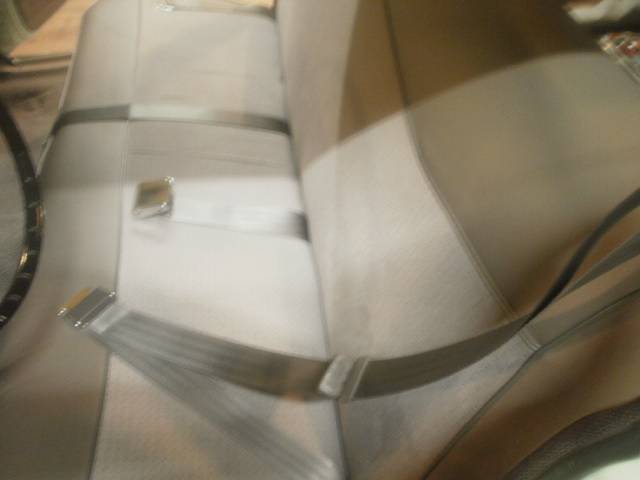

I have done this on 67-68 A body 4 door cars in the past. I got the 3 point chrome latch type through Jegs.
On a B body I'm not sure how wide the post is like the A body and the A's had a nice chrome cover on the exterior post to hide the work.Maybe you can do the same if the Fury model has trim.I was pleased with the results. Shown is a few photos of the 68 Valiant Not the best but All I got
There goes that Idea unless the 62 post is wider than my 63 4 door.
On the 63 the exterior post is narrow.You may be able to remove the trim plate inside and see about a mount there.
On the A body I drilled a 1 1/8'' hole from the outside then a 1/2'' on the inside to install a 1/2'' bolt for the upper mount of the seat belt.The large hole was to install internal reinforcement plate.

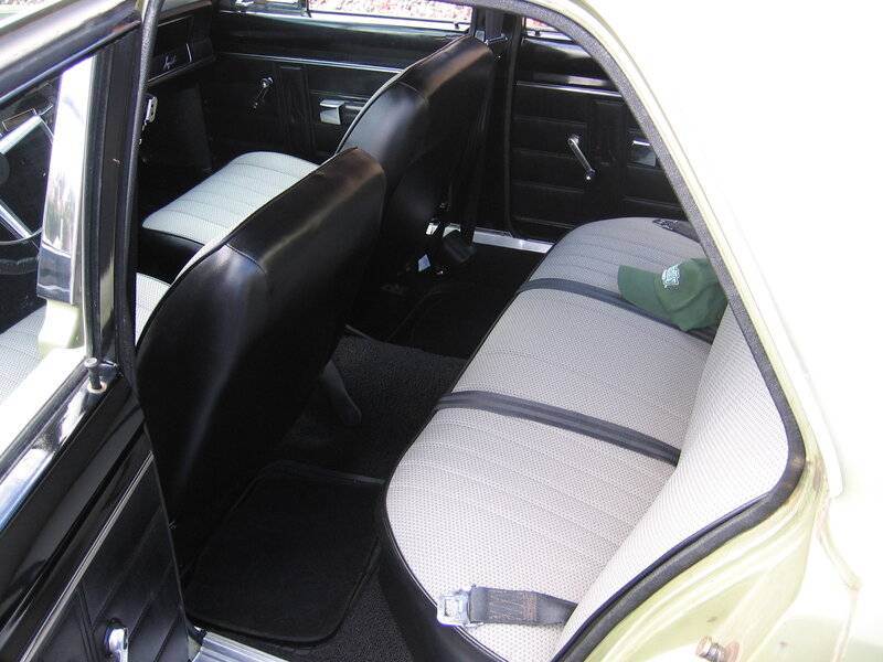

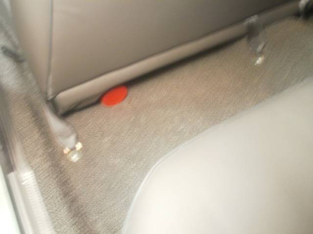

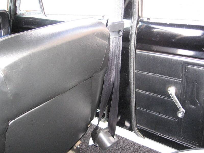

TKMSavoy: The directions give an approximate location/measurement for the "B" pillar anchor plate, but the location can be changed a little based on your seat position, your height, etc. The '62 Parts Catalog lists a seat belt package, but doesn't provide much detail other than "as required." There are existing attach points (welded nuts) on both sides of the driveshaft tunnel for the inboard half of the lap belt. I'd assume they're also in the lip of the floor structure for the outboard lap belt. I think mine got damaged when the floor pans were replaced, so I decided against the retractable type and bolted it through the flat part of the floor. For rear seat belts, I think you'd have to drill holes in the structure, but I'm not positive. I've seen it done though.
TKMSavoy: The directions give an approximate location/measurement for the "B" pillar anchor plate, but the location can be changed a little based on your seat position, your height, etc. The '62 Parts Catalog lists a seat belt package, but doesn't provide much detail other than "as required." There are existing attach points (welded nuts) on both sides of the driveshaft tunnel for the inboard half of the lap belt. I'd assume they're also in the lip of the floor structure for the outboard lap belt. I think mine got damaged when the floor pans were replaced, so I decided against the retractable type and bolted it through the flat part of the floor. For rear seat belts, I think you'd have to drill holes in the structure, but I'm not positive. I've seen it done though.View attachment 1082640 View attachment 1082641 View attachment 1082642
Thanks 69plywgn the pics are helpful, I will check for the weldnut locations. I previously put lap belts in the backseats, there aren’t any weld nuts so I drilled holes on either side of the tunnel and used stainless bolts and fender washers. Hope my weldnuts for the front seat are in good shape or I’ll be doing the same in the front.
