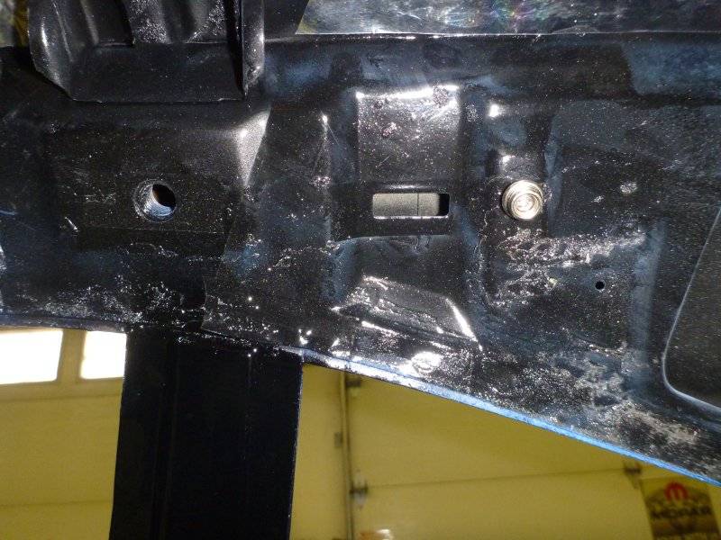

I’ve just bought shoulder belts for my -69 Charger.
There is welded nuts in floor for the retractor and the female end, my problem is the roof mounting, i’ve got a hole but theres no nut and its almost impossible to reach the other side of the sheet metal
Do you know how to fasten the belts?
Anyone did similar installation?
Of course i could Weld a nut in place but maybe theres an easier way?
I appreciate all ideas

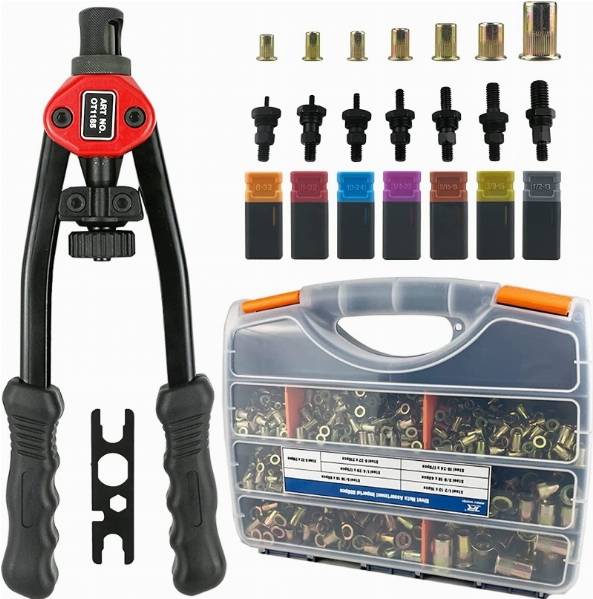

I went with the rivet nut, it really stuck tight in there, gonna fel safe While driving.
thanks !

I sure wouldn't trust my life to a Nutsert.
