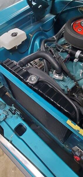

    Hey Guys,
    Thanks for all the suggestions in my other thread. I was able to get my 69 RR 383 with a lopy cam running pretty good by given the timing 12 initial and 36 full. I tried 18 initial but it would backfire and not run well, it seems to like the 12 and 36. Any way, I still have one problem. The temp, while idling moves up slowly and overheats. When it reached 220 I shut it off. I have an aluminum wizard rad with 1 " tubes and a fixed 18" 6 blade fan. My options for this is to get a shroud (383 22" rad originally did not come with it) or go with a 4 spal fan setup, both from wizard cooling? The cheaper option is a shroud but I don't know if that will work and don't want to waste the money. How does the 4 fan(puller) spal setup sound? Do you think that's better than going the shroud route and would it work better? Below is the link to the fan setup. As always thanks for your input!
    https://wizardcooling.com/1966-1969-22-core-mopar-aluminum-radiator-w-4-9-spal-low-profile-fans/
    One more note: I live in FL so it gets hot and also will be adding classic air conditioning.
    -Mark

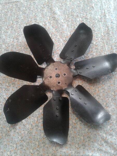

    I have always been a fan of the shrouded mechanical fan. They are not limited to the CFM they can draw.
    Shrouded with a clutch and proper distance from the radiator have always worked well for me.
    My thing with electrics are they are limited to the CFM
    For street use I like mechanical all my cars use this and never had a heating problem

      Thanks, I don't have a clutch and the fan is approx. 1 1/2" away from the rad. I wonder if being that far away is the problem?

      Shroud with fan clutch, sounds like you're not getting enough airflow through the radiator while sitting still. Did you happen to see If your upper hose is under pressure when the engine temp is up? .....by the way 220 is not overheating at all !

        Didn't see it the first read. You are going to put AC in the car. You might want to think about a larger radiator, your condenser will be in front dissipating heat right to the radiator.
        I would run the larger radiator with a shroud, mechanical fan with a clutch

        I would have to change the whole rad support to get a 26" rad in. I don't think I have money to do that, I just spent enough on the 22" rad and classic air. I may have try the shroud option. What would having a clutch do? I mean a direct fan runs all the time, not sure I have the room for a clutch.

          The clutch releases your fan when the water temp gets cooler. So at road speeds you are not spinning the fan as fast because its not necessary, assuming you have good flow across your core. As you slow down the fan engages to pull more air an cool.

                    Under pressure, hose should feel firm not squishy. Your system should be sealed enough to hold pressure, if not you're guaranteed to run hot. Also sounds like your fan is too far away from the Radiator. Get it closer and use a shroud.
                    AND.....you don't need a new rad support to run a 26" Radiator in a factory 22" car.... just cut the opening larger on the passenger side and cover the "new" opening with small black door edge guard, nobody will ever know unless they really look.

                      Yes, I did check the pressure of the hose and it was firm. I'm leaning towards a shroud and maybe move the fan closer with a spacer.
