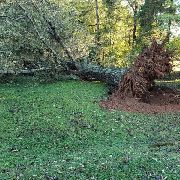

My neighbor lost ( 2 ) huge oak trees and the "abundance of free firewood ( free if I bust my butt to haul, split, and stack it ) has prompted me to figure out how I can take advantage of this and stock up on some firewood . . .

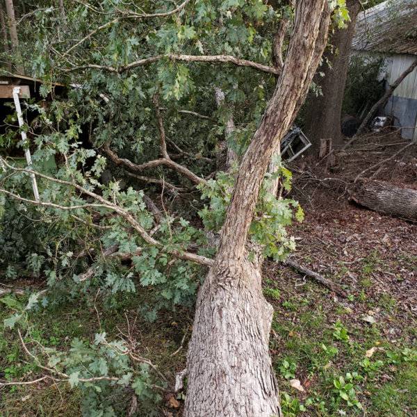

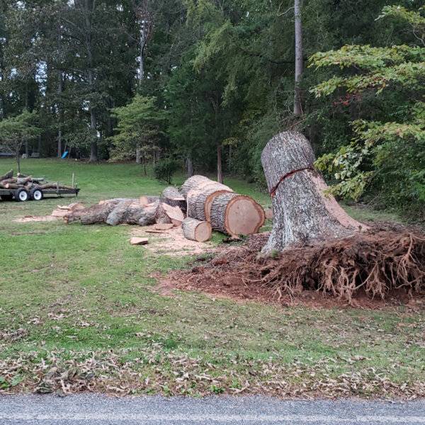

Here's the trees . . . First the biggest one . . .

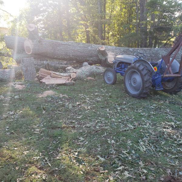

Parked the tractor next to it to give a better perspective of the size . . .

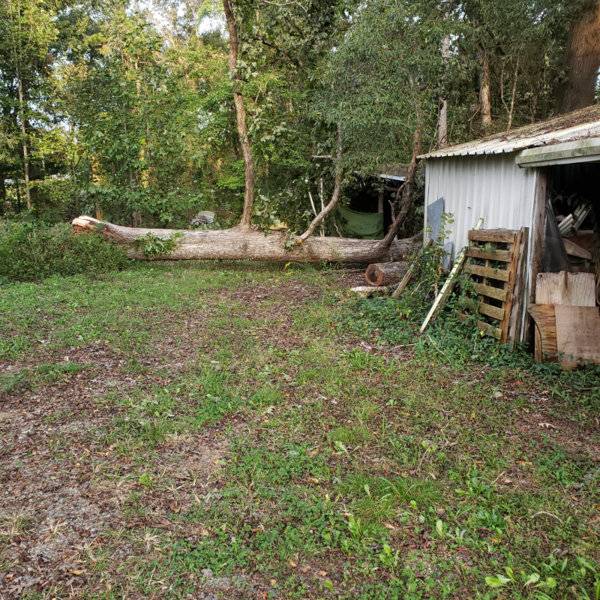

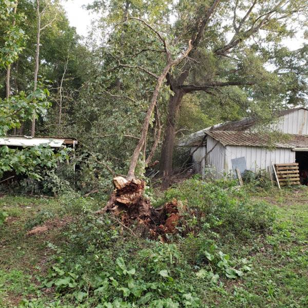

Then there's this other one by his barns . . . .
And believe it or not - it fell right between the two barns . . . no damage ( very lucky )
- he must be living life right . . .
Unbelievable fall . . . really . . .

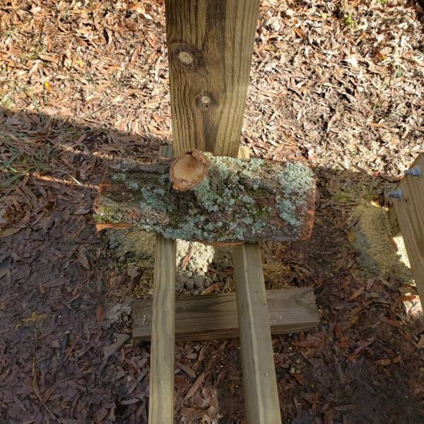

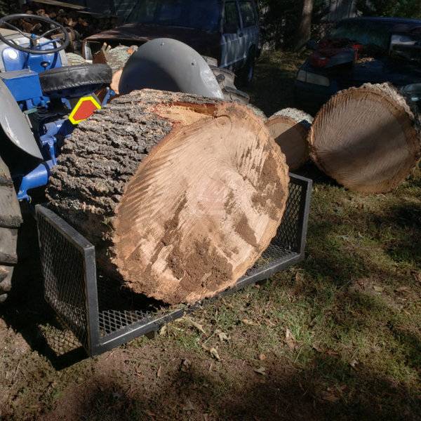

Here's one of the cuttings I hauled back to my house . . .
And the tree "mostly" all cut up and moved . . .

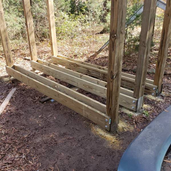

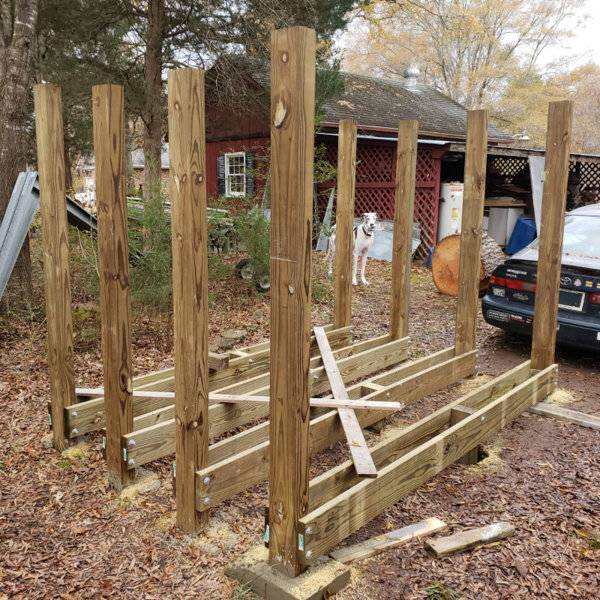

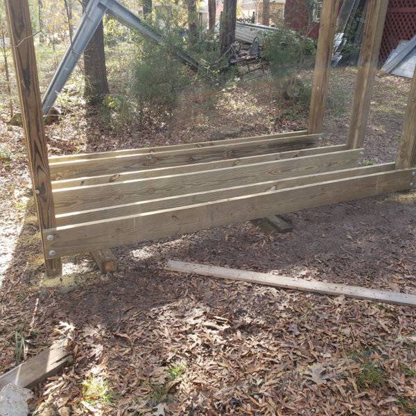

Here's the start . . . started off withe ( 3 ) rows . . . saw it done with 4 x 4 but that was not to my liking, so I went with 4 x 6's . . .

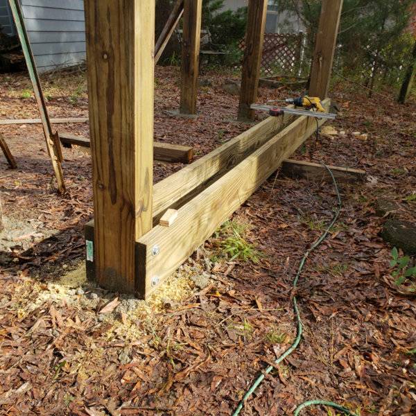

From the other side . . . the 6" width is for better holding of the wood ( as you will see shortly ) . . .

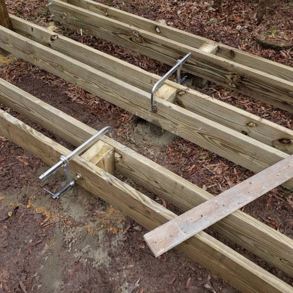

Add a couple 2 x 8's to the bottom to keep all the wood up off the ground . . .

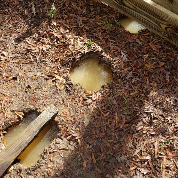

Been fighting with the weather here, and all the rain, and trying to get this thing done . . . my center holes - full of rain water . . .
All (3) of the rows with the bottom support bolted in place . . .

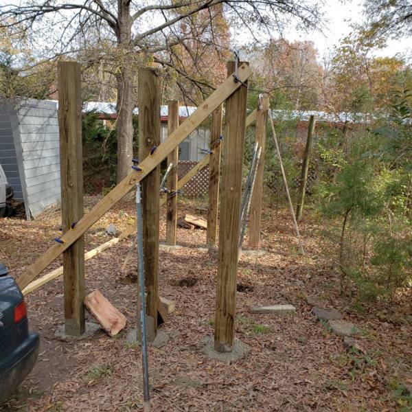

Still need to get the center posts concreted in place . . .
This is the reason for the 6" width on the beam, for better support of the split firewood . . .
Finally was able to get the center posts concreted into place . . .

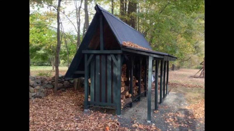

This was the picture that I saw, and liked, and plan on the end result to be similar to this . . .

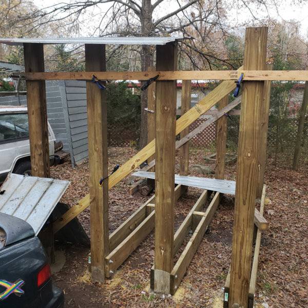

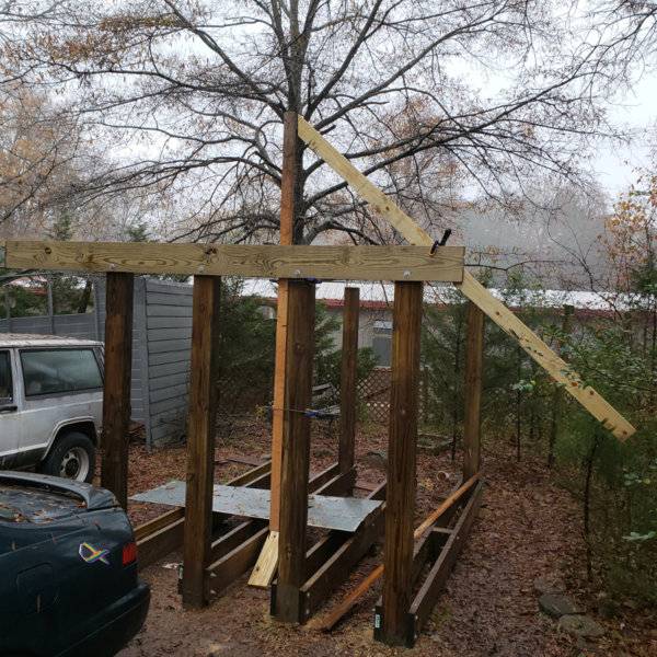

Got one more board up and a couple clamped up in position to show the intent of the roof . . .
The overhang in front will be a tad wider ( and taller ) as to try and keep the rain off me when I have to get firewood . . .
The "front" is to your left ( wanted to get a board clamped up here too - but gave up on the rain . . .
The "back" is to the right and has the roof board clamped into place

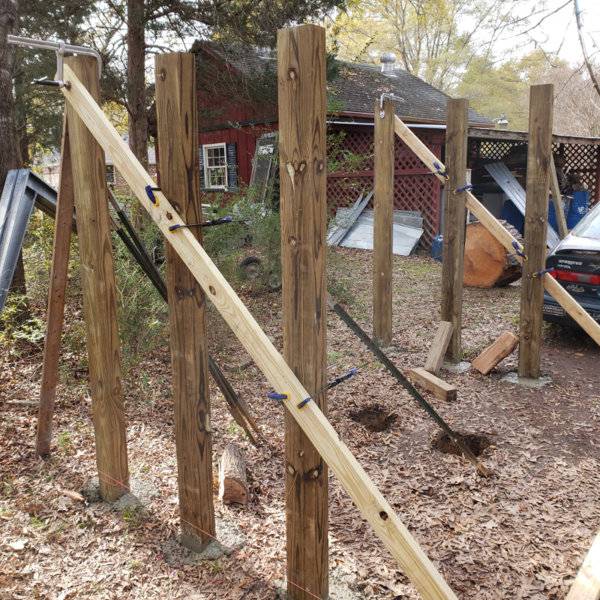

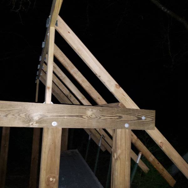

Got a little bit of time in the past two nights, but it's dark by the time I get home . . . so I try using a couple flood lights, but it's not the "best" way to be able to see what you're doing while you're freezing your butt off . . . but made some progress on the shed . . .

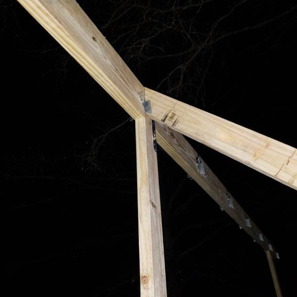

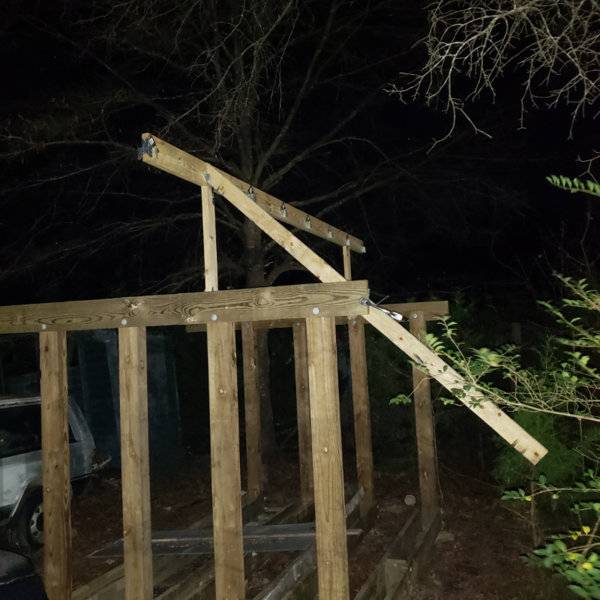

Got the supports in place to hold the ridge beam, the hangers on the ridge beam ( both sides ), got the ridge beam in place ( and secured ), and it's ready for the first side of the roof rafters to go up . . .
This is the rafter to ridge beam connection . . . should work out just fine and support everything . . .

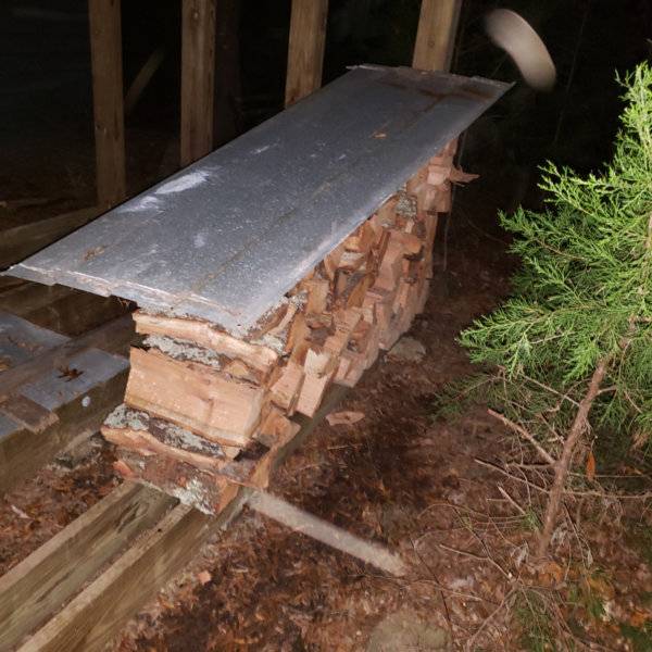

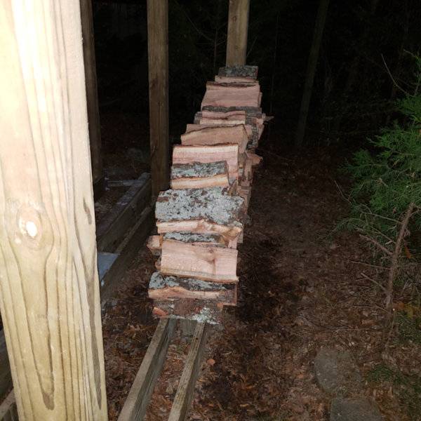

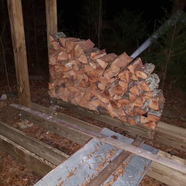

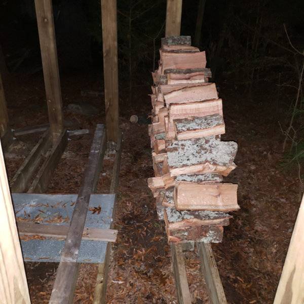

In preparation for the storm, started moving some of the wood for storage ( and drying ) onto the new structure . . . and to see how it was going to work . . .
Looks like my spacing is good as I'll have some room between the rows for air flow and drying . . .
Since the stuff is now "contained", as opposed to free standing ( or I say free falling ) it stacks very nicely . . .
As a temporary solution, if I don't get the roof up before the storm, got spare tin thrown on top to protect it
( sorry @747mopar . . . not tarps here to cover the wood . . . not sure it's all that much better . . . )
Got most of the wood to get the roof up - just a matter of time in the day and the fact that it's supposed to rain all day Saturday . . . we'll see how it all goes . . .
At least with the spare tin covering it, it's pretty well protected and I can have "mostly" dry firewood in the cold . . .

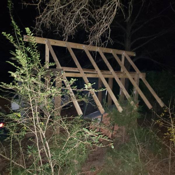

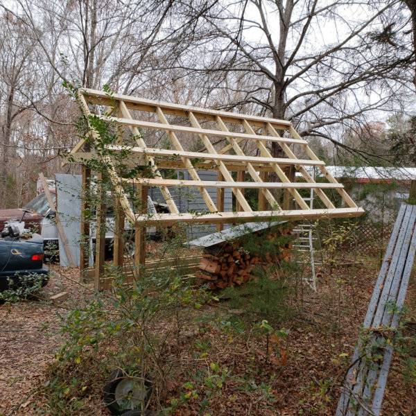

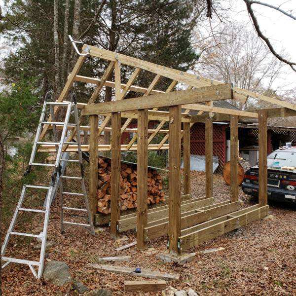

Here's the progress on the wood storage shed . . . pecking away at it a little at a time . . .
Got a portion of the slanted roof done tonight . . . all except the far end rafter as they don't have the support that the center ones have in place . . .
Just a different view . . .
This could help a bit if the snow hits, but I don't think I've got enough time to get it all up before the rain and snow . . .

After fixing up my ( 3 ) screw ups on this project . . . I was able to get all the rafters and purlins in place on one side of the storage unit. Now it's ready to start laying down the tin roofing . . . even got it gigured out ( I hope ) so that the over hangs on both sides will be the same . . .
got the ( 2 ) supported rafters on the other side in place and bolted in ( ugh, just remembered, need to fix that too - # 4 error . . . )
After I got the roof ready for tin, was able to move all the new firewood that was split, so far, into the storage unit and placed tin over them for the upcoming snow storm . . .
