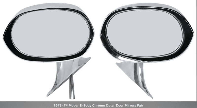

Has anyone else used these mirrors from Classic industries.
https://www.classicindustries.com/product/1973/plymouth/satellite/parts/*881242.html
I received them yesterday and when installed on the drivers side the mirror points too far inward and will not adjust out far enough to be useful without having to lean forward and over to see. Am I just crazy, or are some of these reproduction parts just plain wrong.
Anyone have a suggestion for a sideview mirror that actually works? I would prefer chrome but at this point anything that would be useful will do. This is the second mirror I have ordered and had to return, the first from Summit Racing was simply not the right mount, even though they claimed it was for the 73-74 B Body Satellite.

I will be contacting them today, I really don't see how it can be a bum mirror. The way the whole casing for the mirror is built, it points in towards the car so much that I don't see how it can be useable. When you adjust the mirror all the way out, and it does go all the way out until it bottoms out on the casing, you still see the side of the car. I am only 6' tall and do sit back some, but to see out of it correctly you have to be pushed all the way up damn near touching the steering wheel. I am guessing it is just another sucky aftermarket bad design. It looks great on the car and the finish is remarkable, it would be just fine if function was not a concern.

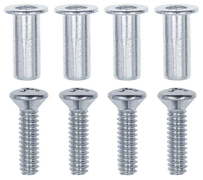

The screws they provided with the mirrors are wood type screws (not machined) that are designed to just go into the holes in your metal which would tear it up with out a backing plate. My original screws are not of the best shape anymore so I bought the machine screws on from classic but they they do not fit within the holes (screw bezel & head is way to large) of the aftermarket mirrors nor do they fit in the originals. They are at least the right size to bolt in your backing plate so they at least got the size correct. These screws are a complete waste of money! I knew they looked different in the picture but it looked blown up so I was hoping they might have a smaller head on them. In the end, I just used my originals even if the chrome heading aren't perfect.

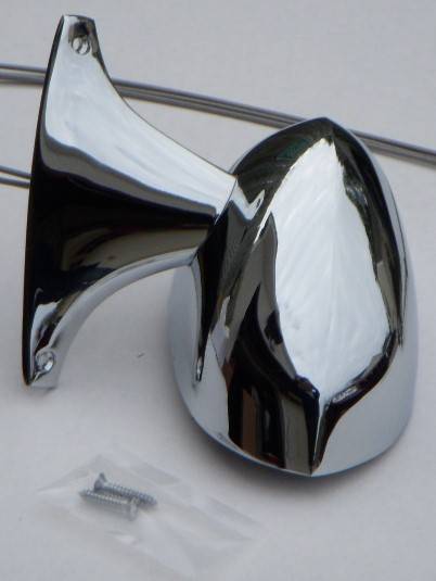

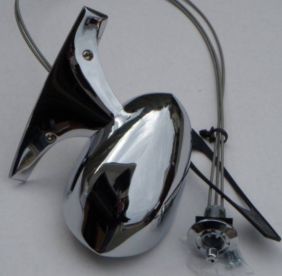

Sorry for the long response, I just wanted to share my experience. Here are some photos & part numbers of the products I bought so you know not to try those:
*881239 - 1971-74 Mopar B & E-Body Chrome Bullet Outer Door Mirrors Pair
MN2882 - 1971-74 B & E Outer Door Mirror Mounting Screw Set

and of course the selftaping screws are wrong for this, they must be machined with small oval head.
these are the ones I got and worked PERFECT with my stock 73/74 backing plate.
