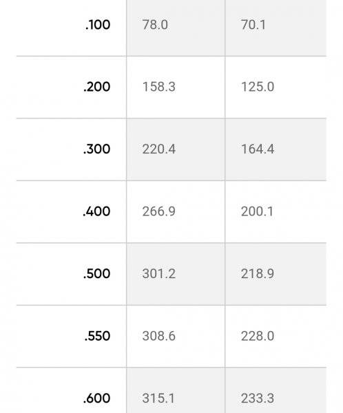

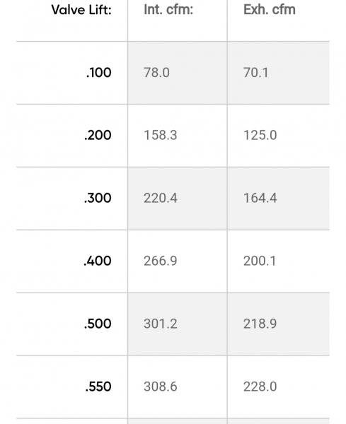

Those are some good numbers and are pretty close to TrickFlow 240s.
