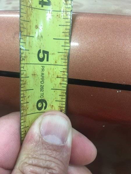

My 67 satellite still has parts of the original pin stripe on it. It’s identical to the Belvedere pin stripe. I’ll measure it this weekend.

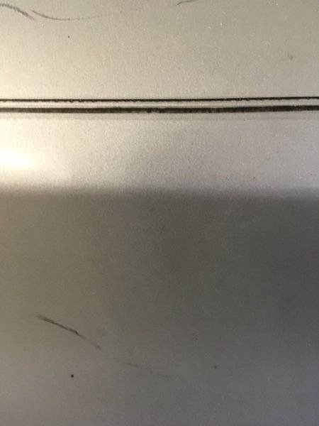

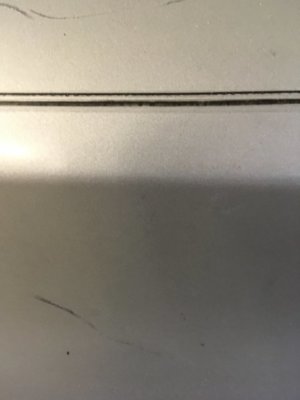

I'm going to be the proverbial "fly in the ointment" and post this link. Notice the last scene showing the side
stripe...it's a double stripe! Look closely at jamey's earlier post with the photo. It's a double stripe as well. Now I am totally confused.

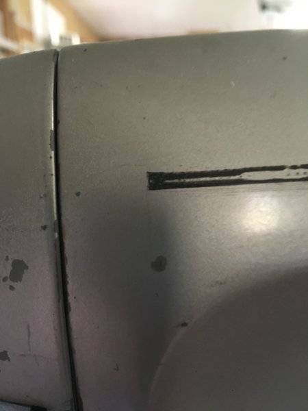

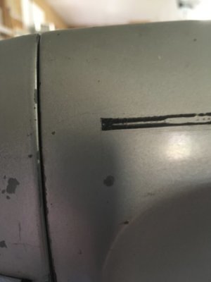

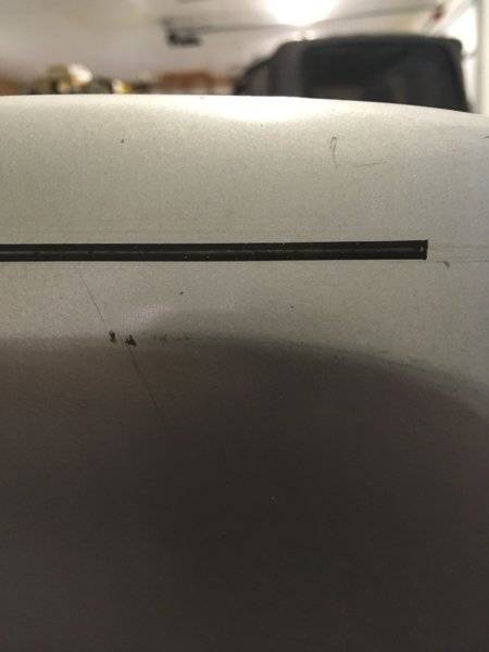

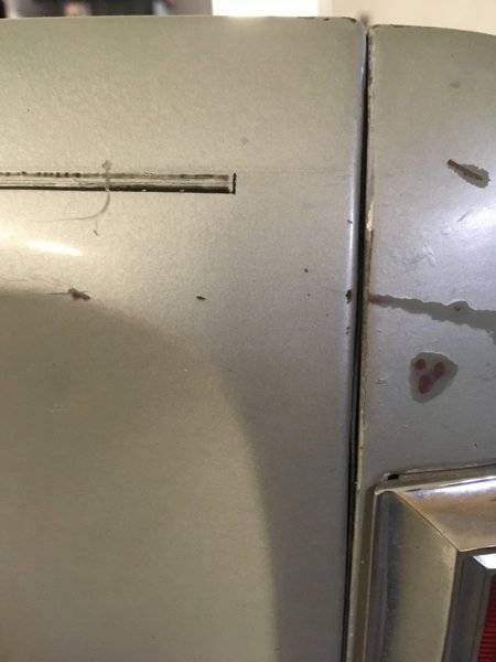

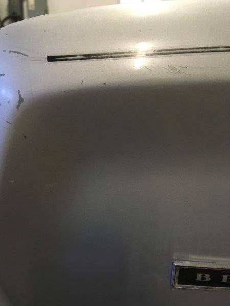

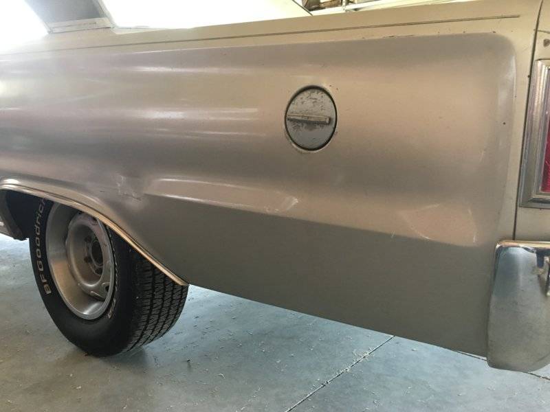

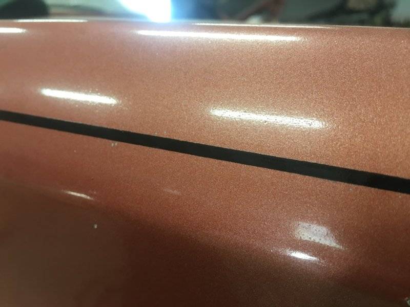

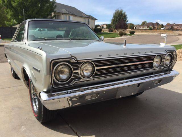

So I had the guy that bought my old silver special take a few pics and send them to me.
This is what he sent me.
27131431-14DA-42B5-BA09-B2997758EA71.jpeg A37BAE89-A42E-4DBA-9308-399C2E60C7FF.jpeg BE1B24DA-1BEB-455C-A769-AAC514D81480.jpeg E582EBAE-C72E-4A1F-9861-FC056C0A817C.jpeg 00A57913-19F4-43B2-A197-1CE7076828CD.jpeg
