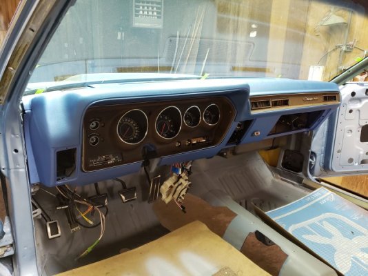

I just did some touch up liquid chrome from Hobby Lobby and I’m very happy with the results. I bought the 1mm,2mm and 4mm tips. I also purchase a white fine tip paint marker in white for the lettering. I’m not a profession but happy with the results. I also did overlays on my gauges along with polishing the lens. I did not redo the black as I didn’t want a completely restored instrument cluster since my car is not restored. Below is a before and after
Well done sir!
