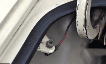

Very similar in design to the door plungers except the one in my 67 belvedere has a 90 degree bend where the wire hooks up. This is the best picture I have at my disposal right now. Zoom in and you can see how it's hooked up.
