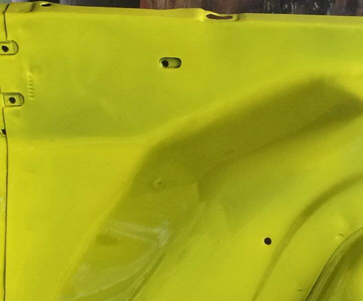

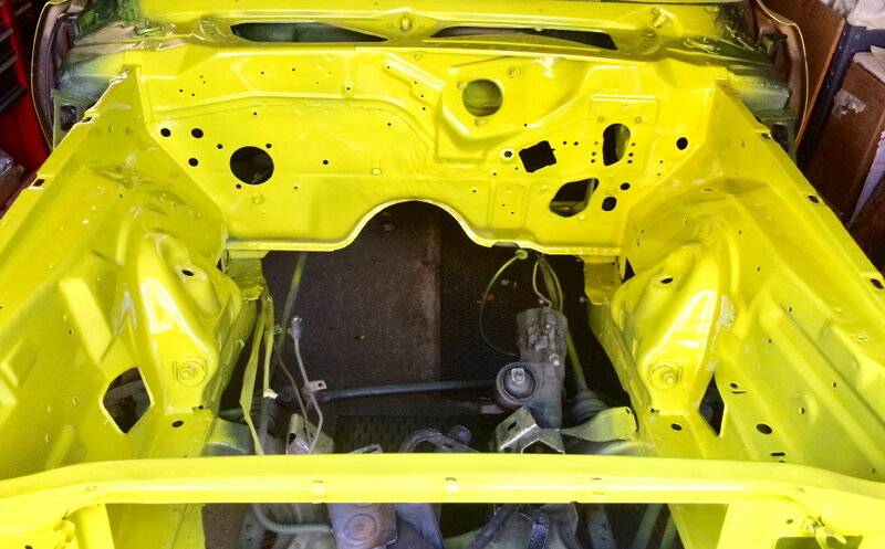

Citron Yella was very translucent. A lot of clear pigment in the mix. Maybe for shine or to add depth. Double coat, let dry, double coat. Thats over light grey primer! Looks nice though

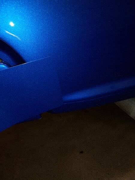

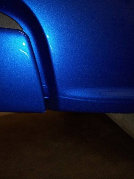

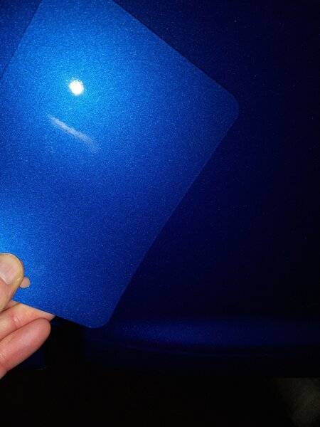

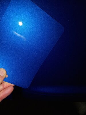

Picture is worth a thousand words. Just painted this on Monday.
FORD N6 blue . A very low hiding color.
Picture of spay out card with black white coverage ( took 7 coats ) .
Brand new tail gate and bumper ends. Sealed with neutral Grey sealer. BAD call on my part , took 6 coat for full coverage .
Repair on box sides done in separate booth load and a black sealer was applied over repair ( 4 coats ) .
End result....... all pieces / card same color .
This was a new alternative formula I had not sprayed before . The spray out card is now labeled with " dark sealer " for future reference and efficiency.
Waterborne AutowaveMM by sikkens for anyone interested .
