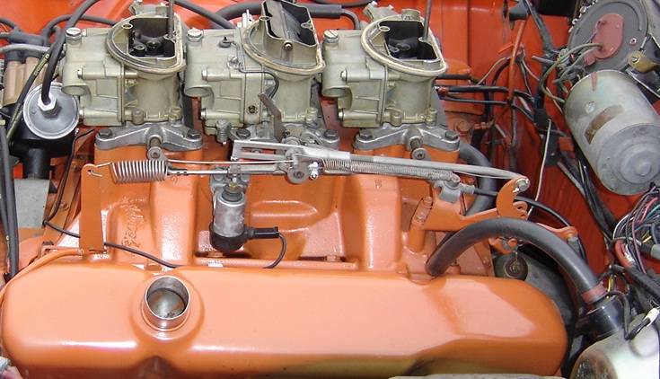

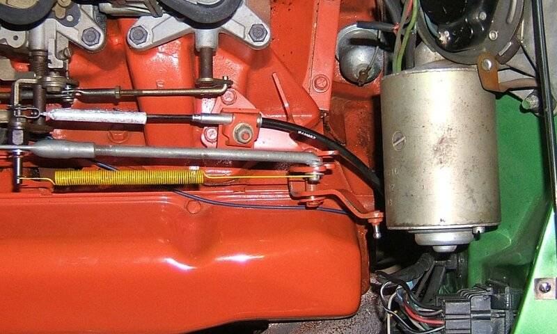

Here are some views of a factory set up. These are available from many Mopar suppliers, mostly transmission specialists. A&A etc...
You can use these to see what the angle is at the linkage pivot points.
View attachment 1084866 View attachment 1084867
Thanks. The view straight down gives me a good look at how long the link to the carb needs to be. So far the only repro parts I’ve seen are REALY expensive but I’ll try looking for trans specialists.
