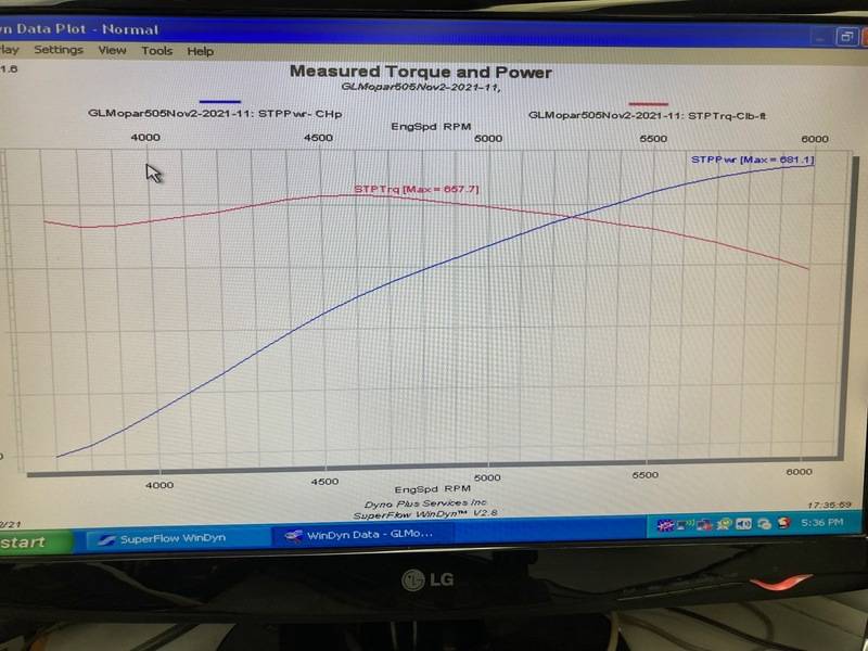

I Ported this one to MAX Wedge Size to fit a set of TF270's we used on a 505, Pump Gas, Street Roller Cam..... 681HP with 658 Ft/Lbs
